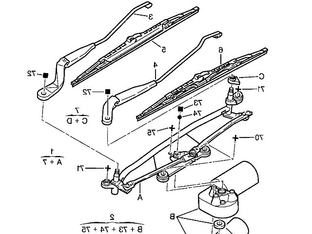

Here's a mirror image of a LHD assembly which act as RHD windscreen wiper mechanism.
I hope it would be helpful.
What kind of knife do you use. Hair dryer tip is a good one
Mine is still factory installed and may be one day I might need this information
