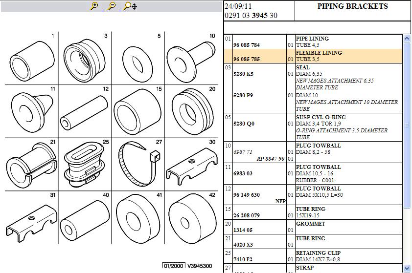

Sorry for the delay, hope the following is useful.
Have not used them in the end, but they look as though they are correct.
Cheers
- Dave -
C8 - Petrol Auto (Love the electronic doors)
Xantia Hdi Exclusive Estate (gone but not forgotten)

i thought you were talking about these
Part Number Description Quantity Price excl. VAT Price incl. VAT Total incl. VAT Selection
5410408 CORRECTOR CUP 3.36 GBP 4.03 GBP 4.03 GBP
5410407 CORRECTOR CUP 2.88 GBP 3.46 GBP 3.46 GBP
5410732 CORR DIAPHRAGM 3.41 GBP 4.09 GBP 4.09 GBP
but the ones you show arnt just H/C seals but general 3.5mm pipe seals,
im sure Martin at Pleiades sells those for a lot less than the dealer,
regards malcolm
