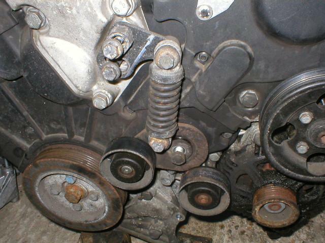

Yes, Dave, no problem in removing the tensioner complete. It comes off as a complete unit very easily after removing the big bolt the whole thing pivots on.
Here's a nice picture of the thing with the car removed for clarity!!!

The pump had a biblical leak Dave :) That shot was taken when Old V6s engine was out during gearbox overhaul and is part of a sequence on cambelt changing...

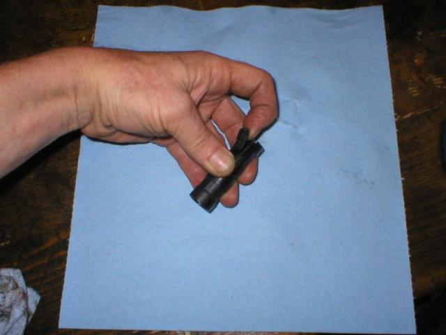

Also, and I've been cauget out like this before on a V6, the small rubber stub pipe on the feed side from the reservoir can develop hidden cracks and splits that weep. It looks for all the world like a leaky pump but it's just LHM oozing from feed pipe down the body of the pump and dripping off the lower hexagon...
Here's the one that caught me out... The split was undetectable and only came to light when I really went for it...
I felt like a right idiot when I finally found it. I'd looked at it twice in the past and never found it and then, thinking it was the pump at fault has Pleiades rebuild it :oops: :oops: :oops: It was that little pipe all along :roll:
