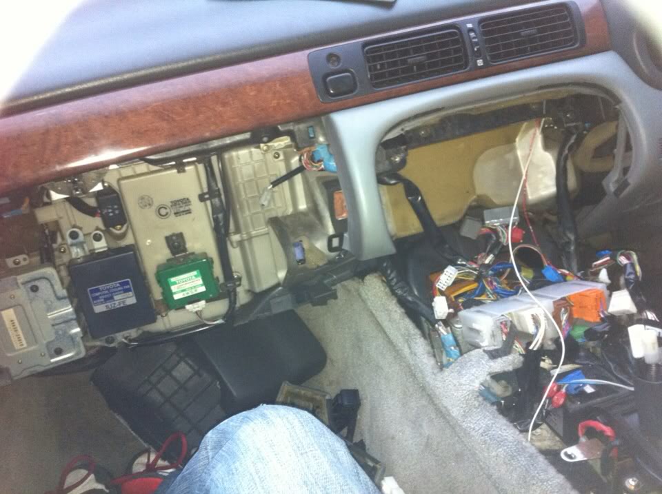

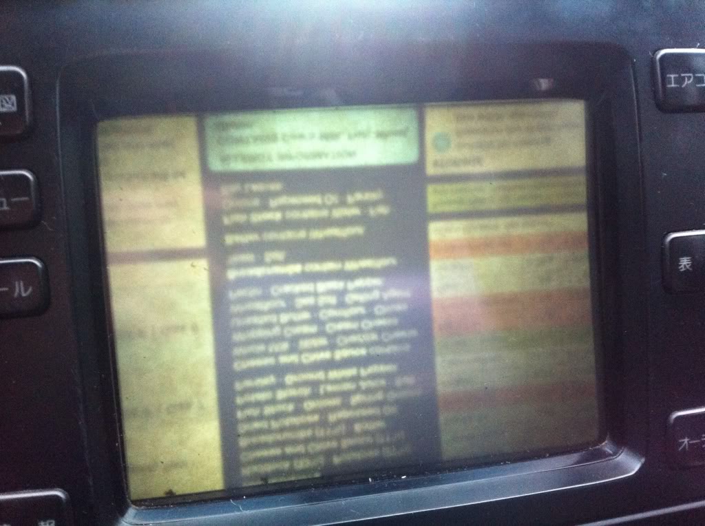

Something my dad tried to sort before was the non working EMV (the touchscreen), on removal we soon found the problem:
Someone had removed the whole unit and replaced it with a piece of cardboard, which you could only tell once you had removed it and got some light behind it!
We then set about removing things to get the dirty carpet out, surprisingly to get to this stage took only a few minutes, all the screws and bolts were wrong though unfortunately so gawd knows how long it'll take to get it back together again
