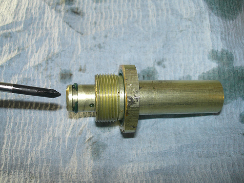

Ok, todays update, just been out and pulled this hydractive block off and i think ive found my leak.
hydractive valve3 by Deanxm, on Flickr
From what i can work out the broken seal is allowing fluid to run past, into thhe small hole in the body then straight out through the low pressure leakoff pipework, i also noticed the leakoff pipe is held on with a new jubelee clip, as if its blown off and had to be held on rather well, if im barking up the right tree it must have been one hell of a leak.

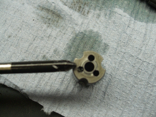

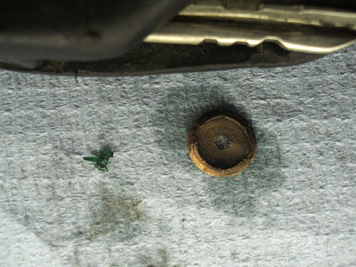

There was also this stuck inside the hydractive block, down inside the port the hydractive valve seats in, anyone know what it is?, also bits of torn o ring stuck in all sorts of places, really shredded it!
hydractive valve5 by Deanxm, on Flickr
Another bit of the shreded o ring

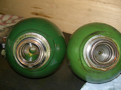

Also im very pleased to finaly see one of the legendary tri nipple spheres
:lol: very different inside compared to its normal hydractive counterparts, there is a much bigger fluid port, ive compared it to one of my non multi layer hydractive spheres.
hydractive valve4 by Deanxm, on Flickr
Any opinions most welcome, like no you pillock that wont cause it etc etc :lol:

That O ring will be a good cause Dean... It'll allow fluid to leak right across it and render it almost inoperative. Well found!
The unidentified bit is a filter basket (unless you mean the object that looks like a small green dead fly). The filter fits over the business end of the electrovalve (in the vicinity of where the broken O ring is) It's not doing anything with a big hole in it and as long as you're prepared to keep good, clean LHM in it then it won't hurt being left out.
One issue is that those small green O rings are a bit hard to source. The big green one up in the body of the valve is the same as on the pump pison caps but the small one is a bit trickier. A standard black O ring won't do as it might not be LHM proof. The nearest I've seen that'll do the job has been in a Lucas diesel Pump overhaul kit.
Citroen don't sell the O rings as a spare part...
If you have huge difficulty in sorting one out, I'll see what I have...
