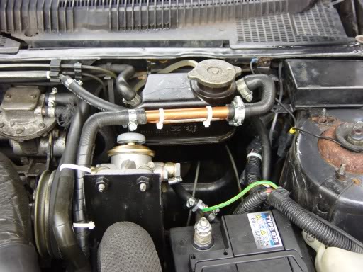

I removed the 'back of block and I like to take air in' fuel heater on mine.
And made this:
Note, cable ties are only there for the 'look' they do not form any part of holding it together
That's the coolant return pipe so always warm.
Looks untidy but does work reasonably well, the derv does not really appear to get more than lukewarm, I think due to poor heat transfer.
Still better than nothing which was the alternative.
I don't run veg, just pointing out a quick DIY thing really, although I made that in a hurry and it could be improved.
Here is an 'in progress' pic:
For reference, the large 'coolant' pipe is standard central heater / mains water piping and the 'fuel' pipe is the microbore central heating pipe, simply shined them up, lay some solder on top and gently warmed them on the gas hob (when no one was looking)
EDIT... Fixed Huge pic.
And made this:
