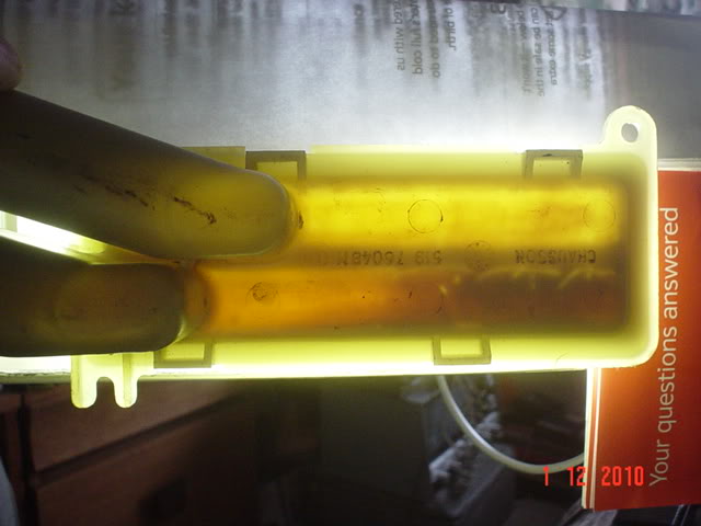

Well I have unearthed the old leaking one I kept for a reference.
There is definately a partition, difficult to show on a picture, but see below:
Just visible through the top holes.
Is this similar to the xantia ?...

Xaccers
- Posts: 7654
- Joined: 07 Feb 2007, 23:46
- x 188
Yup that looks like it, though the Xantia one is black.

G4EIY
- Posts: 186
- Joined: 04 Jun 2003, 18:20
Thanks, there are what looks like aluminium springs that are fitted down each of the tubes, I assume to enhance the heat transfer, or to give the water flow a rotation effect to reduce crud drop out.
