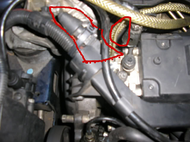

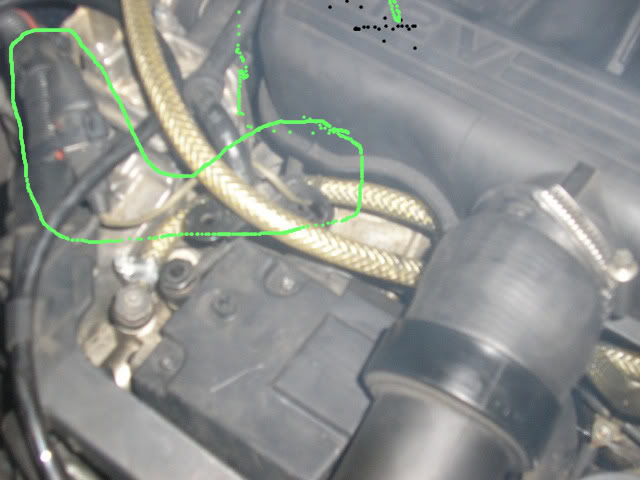

3.Not sure if this has/could have made any difference but have found a plug that appears to need to be held onto something as it has the slot in it hanging loose.This has been cable tied as in the first picture ans the second shows where it runs
Plug circled and its wire
Plug and wire circled again showing it diving towards the injectors

Sorry Jim,was out taking pics when you posted but im hoping that maybe the battery connection and or plug i cabled tied could be causes of the rattle,only time will tell [-o< [-o<

The connector you have circled is indeed the needle lift sensor Colin and yes, it must be well supported.
Ditto the ECU connector. If only one bolt is in it then it will tend to drift sideways and the connections could get intermittent.
Good stuff, lot's of fingers crossed here [-o<
