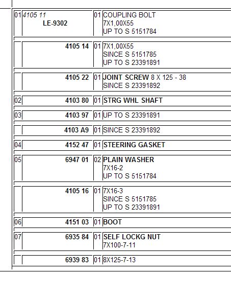

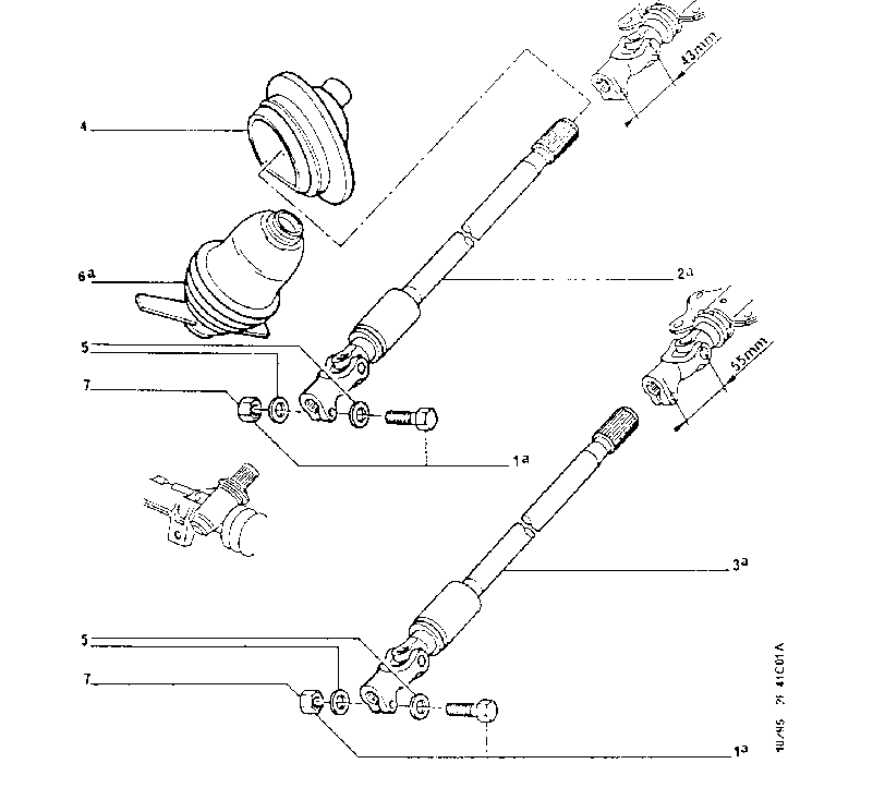

You have to watch this as you are almost on the changeover year.
The later ones have a square fitting into the rack, the earlier ones are round (if that helps)
Also unless someone's changed it, the early models have orange front indicators and twin reverse lights (built into the rear clusters) , the later ones have clear front indicators and the reverse light is in the bumper.
Early is known as 205F , later is known as 205N (typically late 90 / early 91 onwards)
Here is a pic and diagram of the 205F :
I was going to do the pics for the 205N models (the later ones) but that may confuse so I decided against it.

Those are the right pic's then I posted
I've never had to touch one to be honest, the only work I've ever had to do on a column area (so to speak) were replacement of the lock and a replacement rack, but both of these were on a later model.
As you can see from the pics, (working from memory too!) the UJ's are part of the shafts.
Scrapyard maybe best option, but worth a call to the dealer to check price / availability , you never know.
Remember I do not think you can interchange pre 91 and post 91 parts (so you need an earlier model) , none of these pre 91 had PAS (afaik in the UK anyway) so you should be able to find something without too much trouble hopefully. (PAS models have different lower columns again, just to add more confusion)
