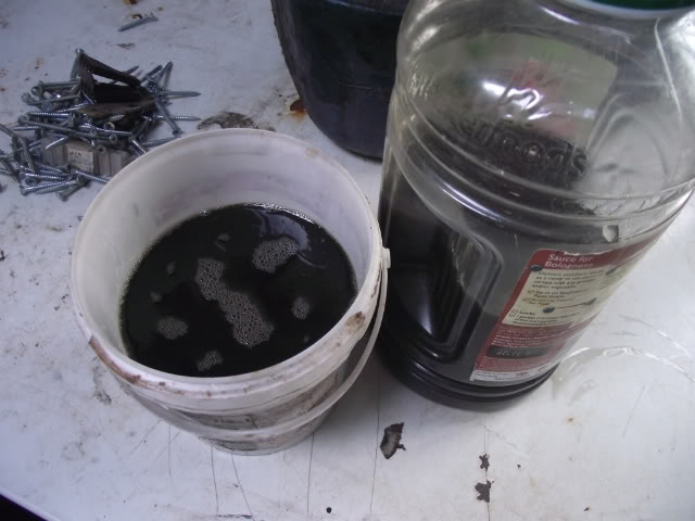

Gearbox oil changed, here's the old stuff, surely it shouldn't be as dark as this (a browny green colour) :?
Posts: 55093
x 8393
Looks 'orrible..
And I'm worried about the pile of screws too :lol: :lol:
Thing is, has it helped the noise?
Dave.P
Posts: 5
Joined: 14 Aug 2010, 15:21
Unread post by Dave.P »
:D thankfully the screws didnt come from the gearbox lol. Unfortunately it hasnt cured the noise, surely the gearbox shouldn't be worn at 28,000 miles, any I'll just keep driving it the way it is and put another gearbox in if/when this one packs up.
