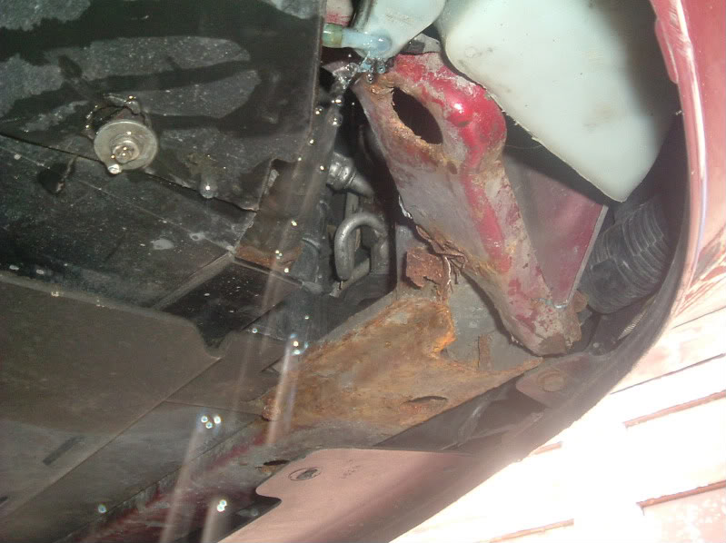

Nearly lost my hands :shock:
I sorted my handbrake cables out,on the calipers.Unsiezed them/adjusted/copperslipped etc. Axle stands,wood blocks aplenty,well supported.
Whipped out all the stands and noticed summat else (crank pulley - nuther post :roll: )
Went under the car again and thought...it'll be alright..just on the trolley jack,while I have a quick look...

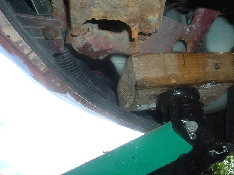

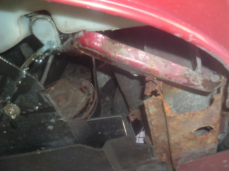

...anyway, in a moment of...ffs,it'll only take a minute to bung some support under it, (so I put some wood blocks under the sill), and,.....Within seconds of me having my hands in/around the driveshaft area...the car sank :shock:
I'd jacked it up on this bracket thing/towing eye/new car tie down thing?
So it dropped on the wood blocks,phew!
Bloody lucky escape,glad I always check the car's supported..even if it is 'gay' ...(anyone with teenagers will understand that this use of over cautioness is gay, apparently :lol: )
So please take care whilst jacking your car,I've been mechanicing (diy) 30 years,but there's always summat can catch you out :wink:

A timely reminder Dave - glad you are OK! I only ever jack / support under the front subframe - or if I have to under the reinforced part of the sill.
Also worth remembering that you should not venture under a hydraulic Citroen unless it is properly supported - the suspension can collapse without warning, and squash you. Which would rather spoil your day :cry:

guilty of trying that place to jack Dave :D
Posts: 55066
x 8391
Main thing is Dave, you were OK :)
Lovely repair, better than new.
Did the washer bottle survive undamaged? Thought I could see spilt washer fluid there...

jgra1 wrote:guilty of trying that place to jack Dave :D
Well now you know mate..unless you like hospitals I'd steer well clear of said bracket :D

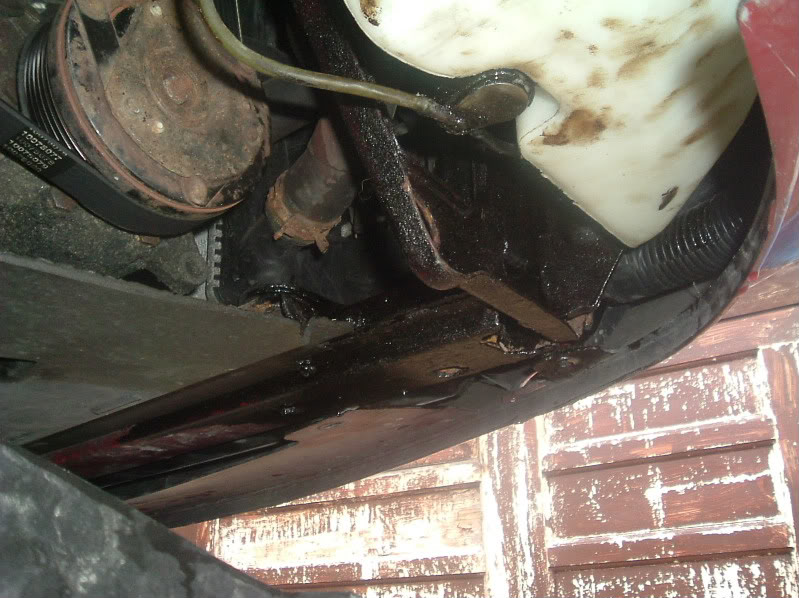

Jim, yes it snapped the nipple off the washer bottle.I've bodged it with superglue/fibreglass and p38 filler,topped off with underseal lol.
When it first collapsed I thought I'd done the radiator in,so bit lucky there :wink:
