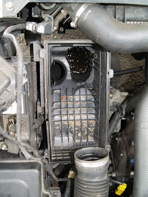

I removed my airbox today, partly to investigate the air hose it breathes through, partly with an aim to test the reversing light switch.myglaren wrote:Mine is in my garden too since I changed the oil/filters last week, was attached with tie-wraps.
I noticed while under the car that the 'hose' from the wheel arch to the airbox seemed to be stuffed with something. Has anyone else noticed this? Is it some form of pre-filter or have I just collected a ton of leaves and muck
The airbox was full of leaves and water:
I drilled a small (1mm) hole in the side and allowed the well to drain a bit - as seen here, It was completely full before drilling the hole.
Removed it and washed it out with the garden hose.
Investigated the feeder hose and it isn't full of socks or leaves, it is just the construction of the hose makes it feel that way, has some kind of lining to it.

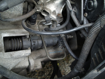

Was unable to get the plug off the reversing light switch, bit leary of damaging the connection but did note that the clutch slave is fitted with a bleed nipple:

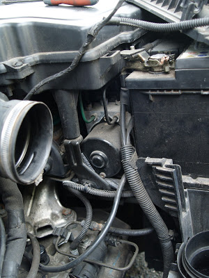

I presume that the gubbins in the centre of this picture is the ABS pump - looks a likely candidate anyway.

I had the same amount of leaves in the box, but no water, hopefully because the arch liners and floppy air deflectors were always in place.
The gubbins are indeed the ABS pump, with the four pipes screwed into the top visible from in front of the battery.

I have heard several reports of that well being full of water and there were lots of leaves and water in there when I changed the air filter a couple of months ago.
I have also heard of others doing the same mod. I did wonder why they put that well on there with no drain for the water - perhaps it is supposed to be there? But in dry climates it wouldn't last long anyway - I suspect mine was full due to me barging through puddles and floods, been lots of them recently
What happens when it overflows
