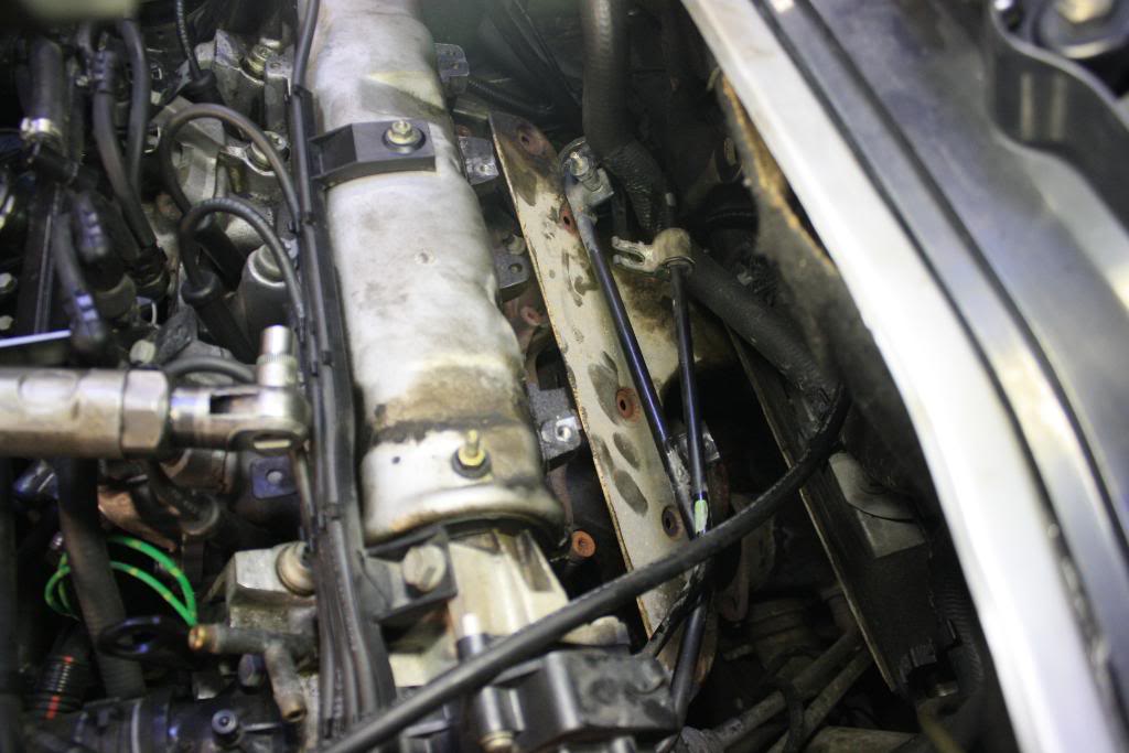

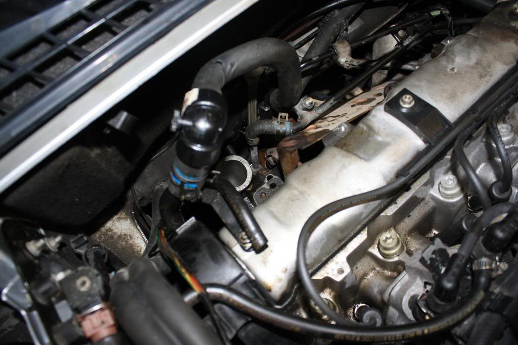

Unread post by Jeth »
Found some pics from my computer:
