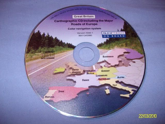

Yes our sat nav systems sound exactly the same, however, my disc is this one:
French is best.

Unread post by KevMayer »
That's exactly the same as my original disk which has been in a box in the spare bedroom for a couple of years or more.
The disc in my photo is the one that's currently in my sat nav and works perfectly.
You can use either tele atlas or navteq maps. Both these companies produce the map discs for the vdo dayton system that we have in our C5s.
Cheers, Kev
02 plate C5 2.2 Hdi Exclusive SE (now 170k miles 03/21).
Used to have:- Xantia 1.9 TurboD SX. 1996 Blue & 1998 Silver Activa. + 1992 BX TZD Turbo.

I've just been to look at my original disc.
It's slightly newer than yours and is for UK/Ireland instead of Great Britain.
But is for the same system.
Here it is in full colour:-
http://i28.photobucket.com/albums/c242/ ... DISC-1.jpg
Cheers, Kev
