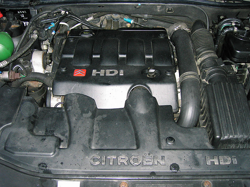

Mine was de-catted prior to me buying it, it has a straight through section of pipe welded into where the cat normally sits.
If yours is a 110 it will have an intake pipe between the engine cover and air filter as per this photo of my HDi
