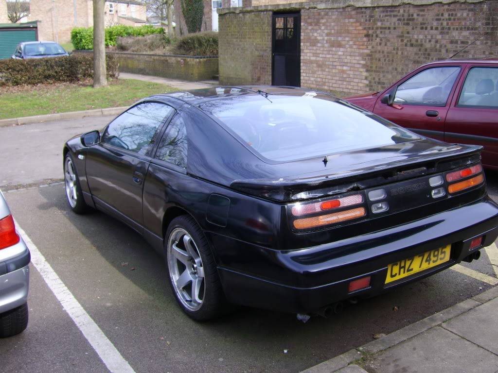

Right been a while so thought id update this post abit with progress.
Well after sorting out the power steering pipe so no more leaks. and then having to chop a large part of the chassis to repair some rusting issues. someone on the 300zx forum, PMed me asking to swap my car for his.
So say hello to my new car
Shes a 1990 British spec, twin turbo. with black leather interior. she has just had (today) a new windscreen fitted here, hence the tape on the window and lack of wiper blades. the rear wiper arm is missing as i removed it due to needing a new blade.
She has a few small niggly bits here and there, but nothing major. she is a strait swap for my silver N/A and needs no welding work, I've been under her and OMG is she clean. the exhaust looks like its still the one from the factory.
She was resprayed to black from silver by the last owner. done 99k miles with full service history by Nissan main dealers to 95k miles. cam belt done 12k miles ago. and also on private plates (though my name is ian not chaz lol)
Main issue was smash to drivers side of the windscreen due owner previous to the person i swapped with, annoying someone an they took it out on the car. the person i just did the swap with, originally bought it to swap parts from this to his. and now having done so doesnt need it any more. so wanted to swap for mine due to the manual gearbox. so he could do a manual gearbox conversion on his car and save him self around £800 for the parts.
And best of all, my insurance never even moved a penny when i changed the details over. she will be going for her MOT next week. as i really cant see anything else wrong with it.
everything else is cosmetic so im really not too fussed about that at the moment. as that can wait.
ooh its an auto as well.
One restoration done id say lol
