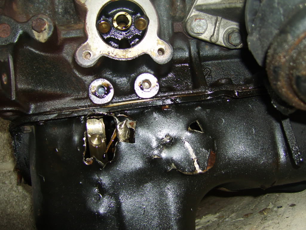

But alas, 83 miles down the road, we heard a crunch noise? we looked at each other and the misses said "that didn't sound too good, might want to pull over", i agreed and lifted my foot off the pedal, i had only been doing 60mph, as i didn't want to "see what she could do" as i had a pregnant misses in the car, and i wasnt used to driving a rear wheel drive either.
The engine rev's dropped to 1500, and all of a sudden, there was an even bigger crunching noise, the engine locked sold and died, and we coasted to a stop on the A87 between a loch cluanie and two mountain ranges in the Scottish highlands, with what can only be described as a nuclear cloud behind us and a trail of oil leading up the rear of the car.
After a phone call to my breakdown people, we had a courtesy car dropped off, and my car on the back of a flatbed.
After i got it home i jacked it up to inspect the damage. sure enough, my assumption had been verified, didn't take long to notice the damage to the oil sump. i had thrown a connecting rod and it had punctured the oil sump, so new engine time.

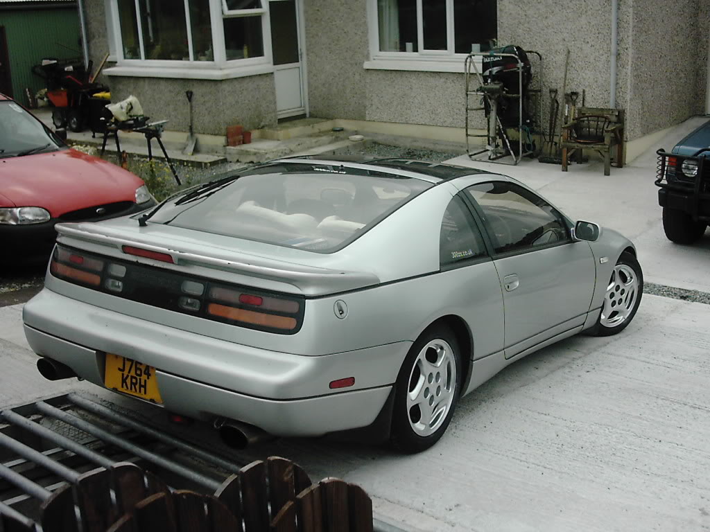

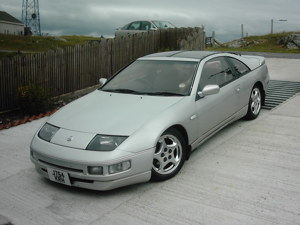

First meet the Lady in question.
This is the engine that blew up....
