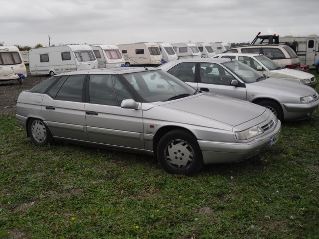

A picture before the clean, (clean picture to come when its light- I.e the morning!)
Below a picture with its sibling the xantia
Yes the seats are 1/2 chamois 1/2 velour, the drivers bolster has worn througn to the foam though!

A smart matching pair! Glad you've taken well to the charms of the Xm!
That's just the leak off return pipe from the front ram and can be found on
Bx's, Xantiae and Xm's. GSF do sell a repair replacement for IIRC 8-9quid
but the clamp holding it onto the ram is a right sh!t to refit.
Better try to stitch a length of LHM plastic 3.5mm return pipe between the split
ends in a bridge with sections of still good rubber piping onto the metal pipe
that disappears into the wheelarch (in your last picture by the lhm stain!)

Looks to be a very nice Xm Dave, even the bumpers look untouched. 8) They look very good together!
Are you now using the Xm while your Xantia is resting?
Judging by that Escrot a cover might be a good investment!
You will have to let me know what you think to the Xm compared with your Xantia :)
