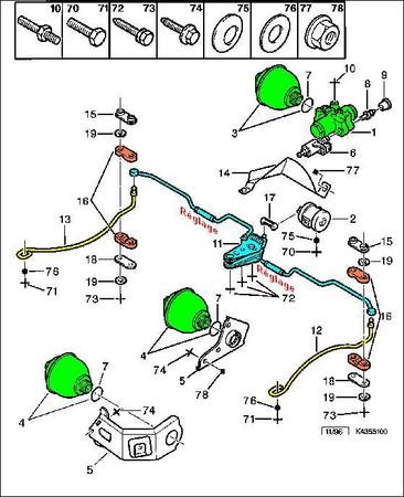

Does anyone know where you can get the anti-roll control rods (13) from? I replaced the bearings (16) to stop it 'dancing' but the rods are very worn as well. Yeomans Citroen said they were £40 but they would have to order them which was going to take some time.

I finally got around to ordering a set of control rods. Part Number C5273337 & C527338 - £36.18 inc VAT (@15%) for the pair if anyone's interested.
While I was in there I also enquired about the price of the Activa sphere's that feed the rams (3 & 4 in the pic) ...deep breath... £91 each inc the Vat. I now understand why people adjust the pressure of an accumulator spheres & use them.

Yes, an adjusted accumulator for the balancing sphere and an adjusted anti-sink sphere in place of the Activa accumulatorSLYTZD wrote:I now understand why people adjust the pressure of an accumulator spheres & use them.
Standard Hydractive rear corner spheres work beautifully on an Activa in my experience...

Before I bought the rods I though I'd have a play with the adjusters to take out the slack then, spent several hours asking myself why I have to try to 'fixing' everything lol.
Haven't had much chance to see what it's handling like, just a quick rally round an empty industrial estate this afternoon. Seems to be handling & sitting ok though. Like you say adjusting the rods is not the easiest thing to do. I took time to clean & grease the adjusters to make life easier.
With the new rods fitted, measuring from the subframe it sits about 5mm higher on one side, I think the guide says something like within 1mm but when it's adjusting the height as you're correcting the lean it's quite tricky.

I think you're allowed 5mm!SLYTZD wrote:With the new rods fitted, measuring from the subframe it sits about 5mm higher on one side, I think the guide says something like within 1mm but when it's adjusting the height as you're correcting the lean it's quite tricky.
Mine always sunk to the left when parked before the new rods were fitted, but sits straight now.
