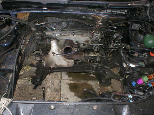

This is the end result of an excellent day...
Someone's stolen my engine!
Ahh, there it is, safely in the workshop 8)
The result was actually a lot of hard work for which I must thank John (jgra1) and his Dad profusely for their very skilled help. It's a three person job, lifting a V6!
The V6 may be a relatively light and compact engine for what it is but despite that it's still a huge lump and with gearbox on the end, weighs a good 260Kg. That's a quarter of a ton!
It's out safely but we nearly got a bit stuck using only two of the lifting eyes. However you use two eyes, the engine/gearbox will tip too much one way or another. What is needed is all four eyes used with an adjustable sling as the engine does need to tip quite significantly at the gearbox end to come out. There's not much space or clearance.
We had some fun pre-jobs. Prior to John's arrival I'd drained the coolant, disconnected the coolant hoses and in doing so I made a terrible discovery, of which I'll speak more of later, drained the coolant, drained the oil and removed the A/C compressor from the engine and left it dangling on a rope. Funnily, removing the A/C compressor on a 1.9TD is an absolute devil of a job but on the V6 it's an absolute doddle
To get the A/C compressor off, I had to remove the Aux Belt. Thankfully, the V6 uses a sensible automatic tensioner and again the job is a doddle and a half compared to the miserable job it is on a 1.9 or 2.1TD.
Similarly the radiator
Just before John's arrival I disconnected the lower engine mount. All ready to lift now except for one thing.....
The exhaust mainifold to cat union
John's timing was immaculate..
What a struggle. I laid under the car holding the tops of the bolts and John worked from the top. Access, even by V6 standards, is at best described as "poor" and I ended up soaked
A theme is emerging now. A V6, despite filling the engine bay, looks impossible to work on but time and time again I've found many jobs easier than on say, an Activa. As I've sid in the past, the V6 is a brilliant piece of design and packaging.
We did have to fully remove the ABS block to give enough room to lift the engine, along with the steel LHM return pipe that runs across the engine bay over the top of the gearbox. Cue an LHM Shower
Speaking of showers, we were lucky with the weather
The last job was to slip off the exhaust headers whilst the engine was still dangling from the crane as it won't sit down with them in place. John's expertise in removing the cunning spring-loaded clamps from the exhaust manifolds was invaluable. They're like a giant version of a metal EGR hose clamp but made of some incredibly springly material that exerts a massive clamping force.
Right, I said I made a nasty discovery in disconnecting coolant hoses. The car has a bypassed heater matrix for reasons as yet unknown (its going to be replaced as a matter of course) and the elbow joint is smashed. There is also evidence of a big coolant leak in the vicinity. Removing the header tank I was surprised to see some nasty, grey slurrry with the consistency of wet cement runs out of it. I then looked and found a load of it inside the tank.
Worse though was when I disconnected the hoses from the transmission cooler. The cooler is full of this nasty stuff
So now it's all perfectly clear why the gearbox died. The car had a matrix leak, someone put a bottle of heaven knows what in the coolant and it blocked the transmission cooler and the end result: a cooked gearbox.
I've no idea what the grey slurry is; for all I know it may be cement!!
Bloody expensive matrix, that
Whilst the engine is out, it's having a new cambelt and waterpump. It would be sheer muppetry not to replace these items whilst they are beautifully accessible...
At leaast now engine and gearbox is in the workshop I can work rain or shine
Finally, a huge thank you to John and Dennis for all your help today

Ahh, now there's something interesting Kevred_dwarfers wrote: I see the suspension rams on the V6 are a lot taller than the others to get the front of the car up that high
Suspension is largly identiacal.
With the suspension depressuirised and the car on axle stands under the sill front jacking points, the car sits more or less level
Looks like it has near perfect weight distribution
The car looks high at the front now because with the engine and gearbox gone, the rear has finally sunk!
I'll give the whole cooling system a good flush, replace the matrix and the transmission cooler.
Thankfully, the coolnat that ran out of theengine waas a clean as a whistle but I'll have a good check of the internals when i do teh water pump.
I'm a bit worried about the rad but it'll get a flush although it wont be a good one as all pipes go to one side only...
Shame is that it's in good nick so I don't wat to replace it if I can salvage it.
