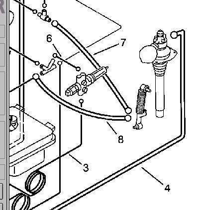

superloopy1 wrote: I'm going to renew the flexible pipes to the front ram at the same time.
Like to hazard a guess at the part numbers for these?
I'm seeing what I think are 5270 T0 and 5270 T1, but why are they different?
Something to do with the pressure rating maybe?
They're the right part numbers Mike.
There's two of them on the ram and they're a tad different in length I guess, hence the different part numbers.
Items 7 and 8 are the pipes in the picture below:

superloopy1 wrote:I'm going to renew the flexible pipes to the front ram at the same time.
As Jim states, they are the correct numbers and one pipe is longer than the other, which one is longer is not obvious from the diagram. When you fit the new hoses make sure you position them so that they don't rub against the inner wheel arch as that is what causes them to wear out which at about £70+ for the pair makes it worthwhile spending time to achieve.
The new hoses I fitted to Jim's Activa should be fine :lol:
