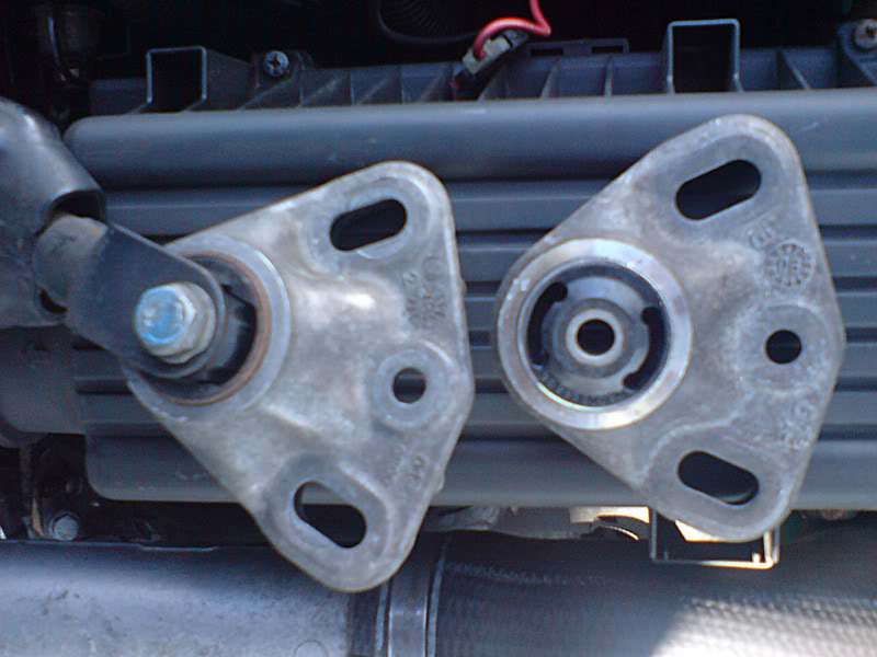

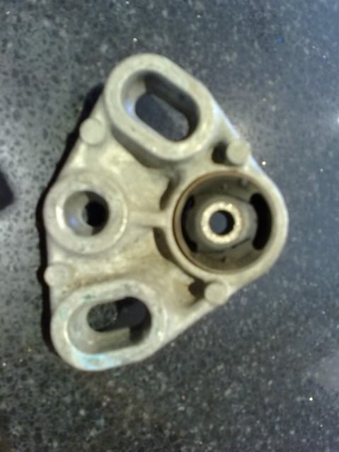

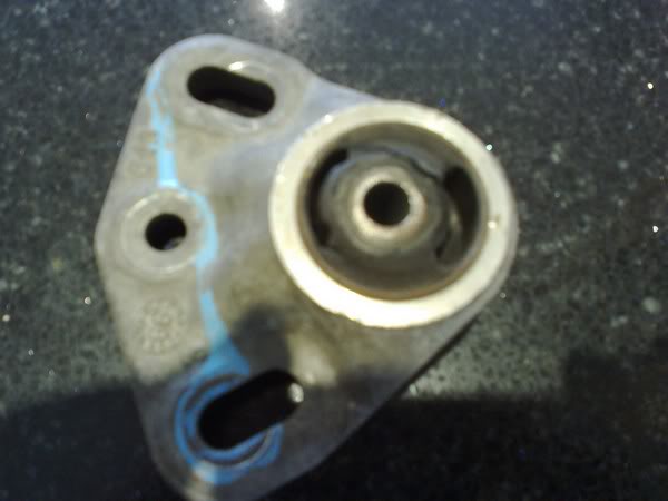

Hi Chaps.....
My stealer finally got the part in for me and I performered the job a the weekend (Not in chinos though :lol: )
As James mentions above the bottom bolt is a bit of a nightmare but got there in the end
I took a couple of pics of the culprit:
Cheers again for the helpful info..
Gav....
