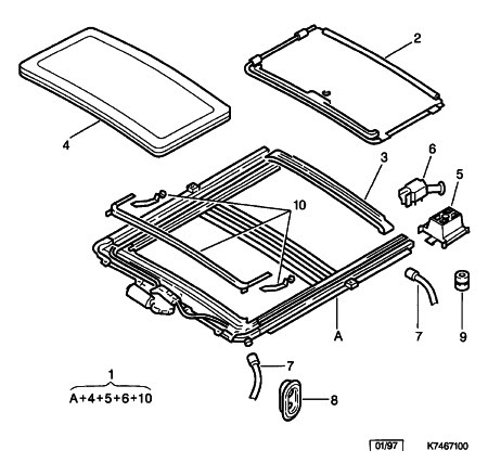

Thanks for this, especially the diagram! This morning I missed the button for the rear window and hit the sunroof one by mistake. Roof slid back a bit before I removed my finger. Moved forward and then stuck again. It looks as if it is at the point at which the whole thing moves up to lie flush with the roof. Closer investigation in daylight follows.

Not sure where you are at with this now but if you are stuck I suggest you remove the motor from inside the car, undo the retaining screws which hold the glass in place and remove that if possible. With a bit of gentle force you should be able to push the cables back and forth. Depends how bad they are stuck. If you are lucky and you should be then you can re-seat the glass in the correct place.
The bit you should be moving is part 4 in the diagram. If you you can get some oil in there then great. If you are really lucky the roof may work again. I suspect a cable is worn though.

As you can see on the diagram (item 2), there is a driver relay for the motor. This means that the operating switch rarely is the problem, as the contact sets only carries the small relay coil currents.
I suspect you may have a problem with corrosion in some of the connectors, or even a burnd out realy contact set. Could also be the motor thats got worn brushes.
The relay is a special double changeover relay, to make it a polarity shifter for the motor. It can easily be replaced by 2 standard switchover relays, if you are a wizzard on car electrics.

If you try and turn it manually whilst jammed it will damage the teeth on the cog of the motor. Do as I said. You should be able to get the cables moving. May even have to place something solid on the base of part number 4 and give it a tap initally just to get it moving. Once moved you should be able to push the cable along. If you look inside the car when this is done you can see the cable moving where the motor sits and may be able to identify any damage. I do think you will need a new cable in the end though
