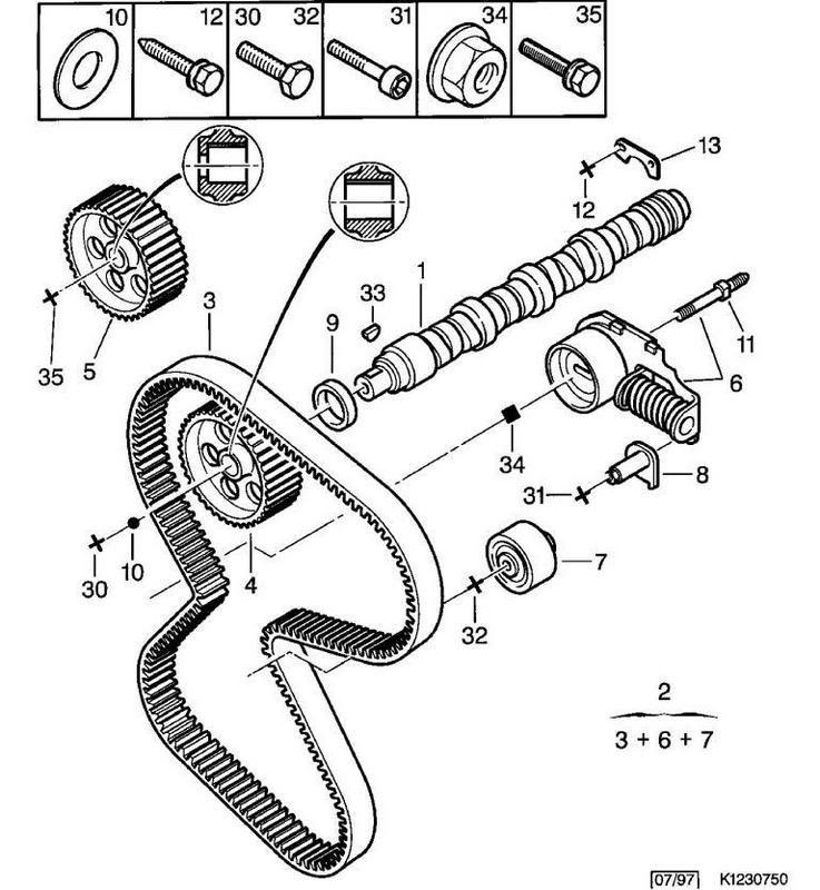

I've just looked at this on pr.net. I've never had any experience with a 2.1TD but the tensioner is very similar to that used in the early petrol XU engines and I do know those.
You'll need to remove the nut/washer (Item 34 on Item 11) in the centre of the tensioner wheel or remove the nut at the rear of it behind the tensioner assembly (if you can reach it. Also, you'll likely to have to remove the lock plate (allen screw) and pop off the spring (not as strong as it looks :) ) and then it will slip off.
Here is a picture of it:

Thanks for that info. Please tell me where you got the diagram from.

From (the now sadly deceased :cry: ) pr.net. It was the last thing I looked up on it :wink:
It is safely stored on my hard disk though as a jpeg...
