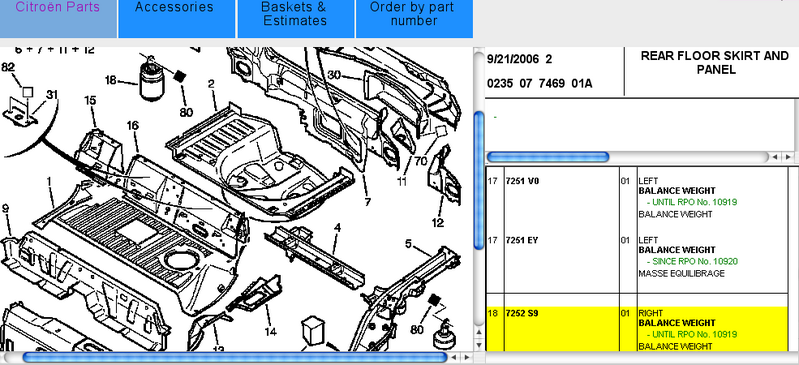

Following a incident involving reversing over a rock. inspecting the damage reveals a broken bracket bolted to the chassis on the drivers side (UK).Comparing with the passenger side there is what looks like a large metal weight missing. Any information on what this is for? is it just on the Pluriel? etc.Any info appreciated Dave

Mind, Pluriels aren't off road vehicles you know!!
Does look like a balance weight is fitted to both sides although one on the
right of the floorpan does look a lot larger in the illustration off Citroen's
parts database. Hope this helps!
Andrew
BTW; The illustration got cropped at the bottom where the far right bottom
part is number 17 - the second balance weight!!

Thats more like it, thanks. Regarding this Citroen's parts database, is this something I can get access to? if not does it give the part no for the bracket that holds the weight to the chassis? Any info appreciated Daveandmcit wrote:Mind, Pluriels aren't off road vehicles you know!!![]()
Andrew

www.citroen-pr.net
All I did was register myself using my Graphic Design company address and
listed my local Citroen garage - there shouldn't really be a problem although
Cit HQ did 'kick me off' a few times early on! Mind locally I'm "well known"
as quite (OK a BIG) Citroen nutter by them - they've even sent people to me
after odd Cx parts and I have bought loads of stock from them in a their
redundant stock clearouts.
According to the listing there doesn't appear to be a bracket only a nut
(number 80) from the inside onto a stud at the top of the balance weight.
Andrew

Just as I dreaded, I have since been back to the scene and retrieved the weight,it must be 3x times the size of the passenger side one. When the car is back here this afternoon I am going to see if the "brackets" are interchangeable, that way I may only have to buy the smaller weight...wheeler wrote:both sides are definitely different sizes,the bracket with the bolt holes comes together with the mass.

I'm purely guessing here, so follow me on this one
that for whatever
reason Citroen decided to fit these 'balance weights' (the suspension ISN'T
THAT soft surely
) the primary difference in size/weight will be to
balance the slight offset of the spare wheel in the boot well?
I would imagine the fastenings will be symmetrical but that doesn't simply
mean you can turn one bracket around 180? - we are at the end of the day
talking about Citroen here!! If the design engineers can complicate things
further, you KNOW they will...
Mind, there have been a few Pluriels being scrapped on ebay
- worth having a look.
Andrew

The parts and prices for a random left and right weight are:
00007251V0 FLOOR BALANCE WEIGHT 72.58 85.28
00007252S9 FLOOR BALANCE WEIGHT 112.89 132.65
Andrew
