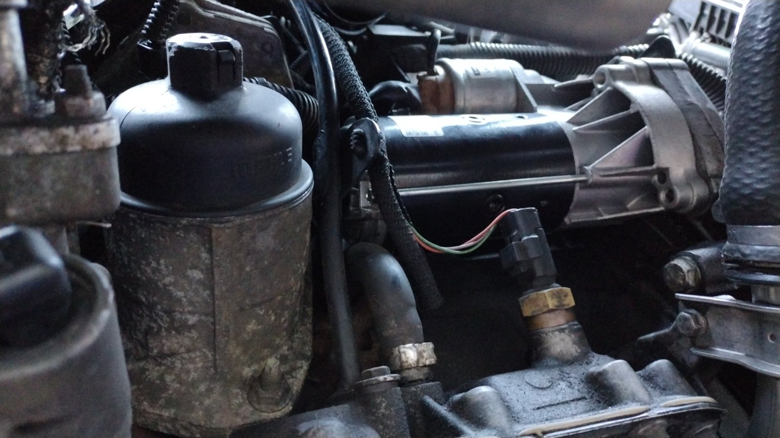

Crankshaft sensor is very vulnerable, seems ok:

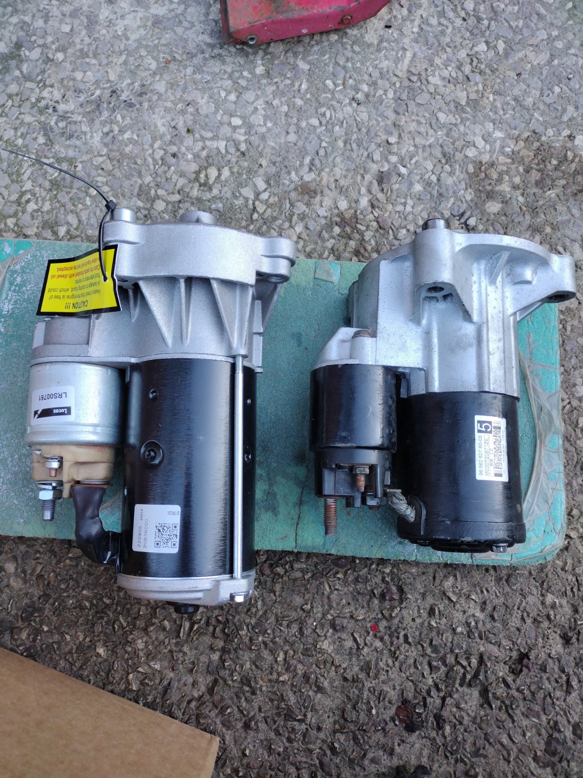

If you look really closely, you may spot a slight size difference between new (left) and old (right) starters!
Mounting points match up, now to see if I can squeeze this beast in to place!

Re: C5 X7 no start (or only runs for fraction of a second)
Was about to give up on the basis it just does not fit.
But it does! just!
But it does! just!
