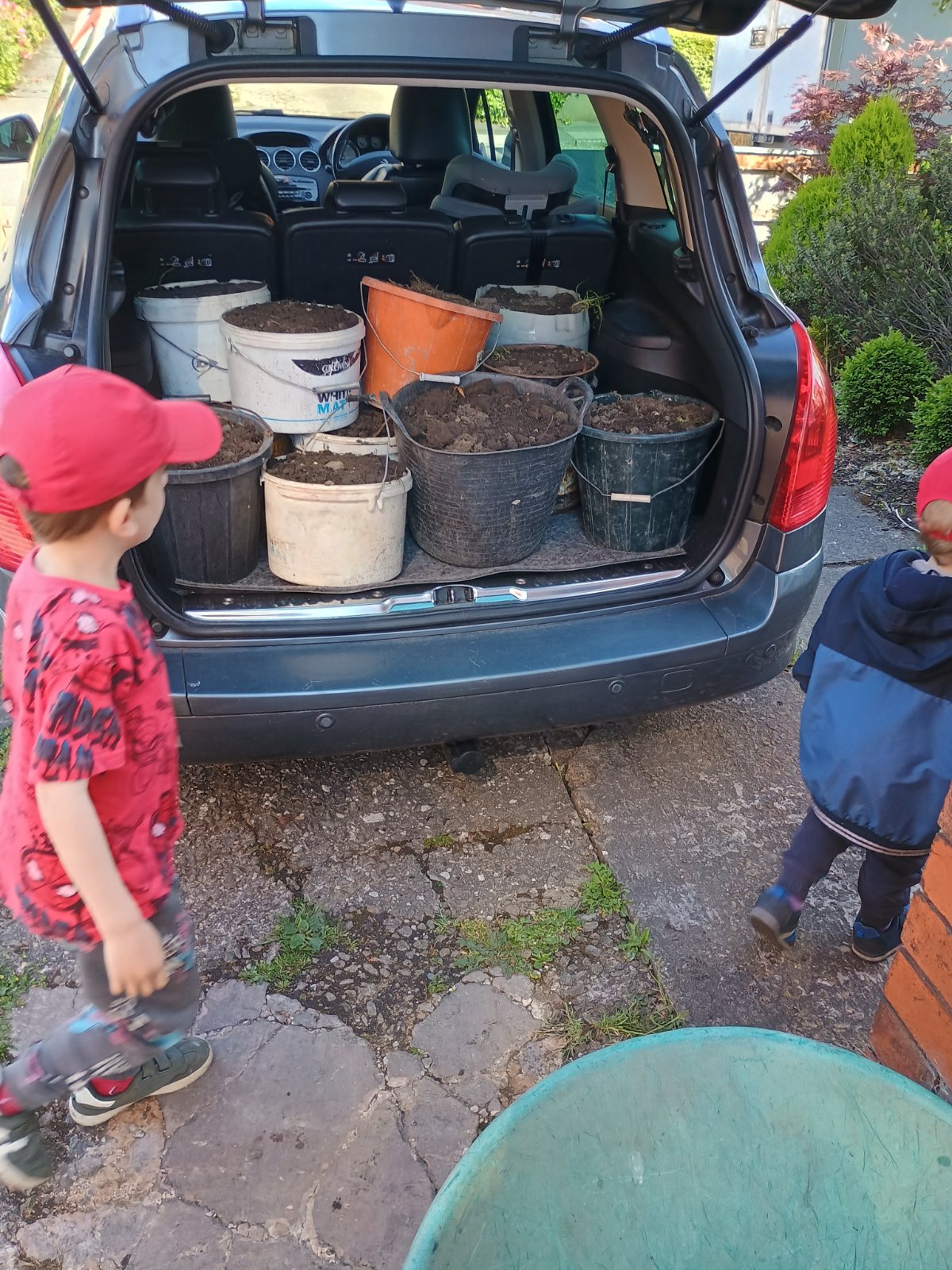

I'd like it to be understood, we operate an equal opportunities suspension abuse policy here!

My two little Tip Trip buddies pictured too

New craze a moblie garden , take it wherever you go, as the old logo once said take my breath away(407 era) , Matt has now made a new one , take my garden away ........
