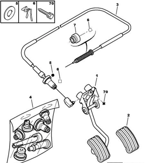

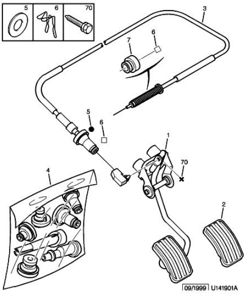

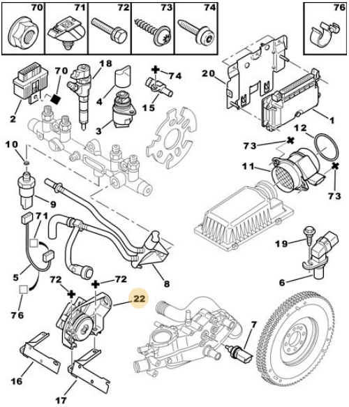

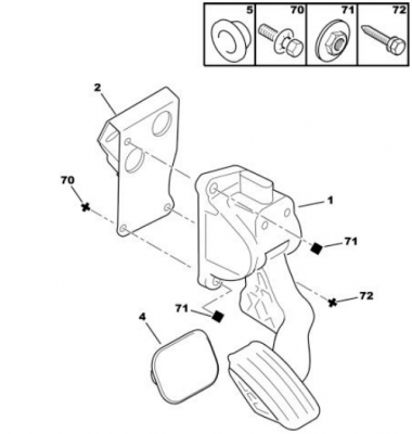

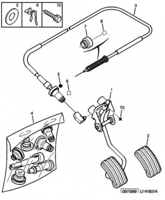

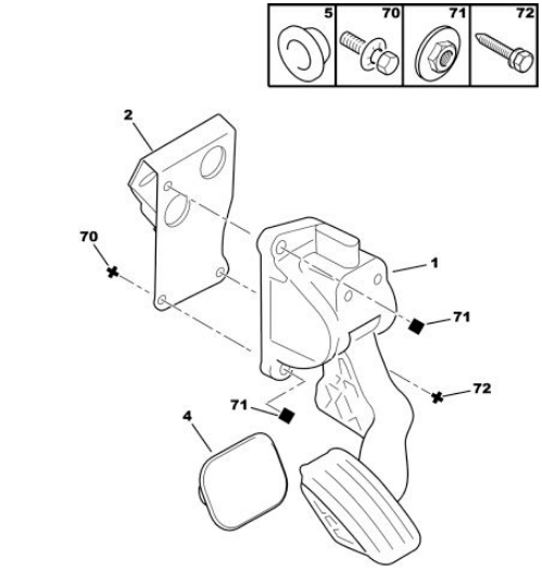

XSARA PICASSO FAMILY SALOON 2.0 HDi 90 Manual gearbox 5
You could have one of the three setups for this year:
ELECTRIC PEDAL WITH CONTROL INCORPORATED IN PEDALMECHANICAL ACCELERATOR PEDALPEDAL CONTROLLING THE REMOTE ELECTRIC SENSOR
Part 1920X1 is for item 22, but it also says add part: 1608878580. So I'm not sure whether the potentiometer is separate to the mechanism.....

Hi it is on fourth picture coresponding to explanation : PEDAL CONTROLLING THE REMOTE ELECTRIC SENSOR...with 4 wires

The lads xsara picasso is the 1.8 dohc petrol engine, with the last parts picture part number 22 type throttle pedal position sensor, the 4 wire type.
I think i will strip the unit down as far as possible to check to see if it has 2 half moon magnetic segments, probably affecting a hall effect array?
weather permitting ( it rains a lot here ) we will solder the wires back in the loom by the units connection plug along with break out wires so can connect scope for a look see. It would make sense that one wire is earth, one wore is 12v power, and the other 2 wires being outputs to the ecu?? similar to the pug 306 hdi diesel......
the picasso has a sagem ecu....
