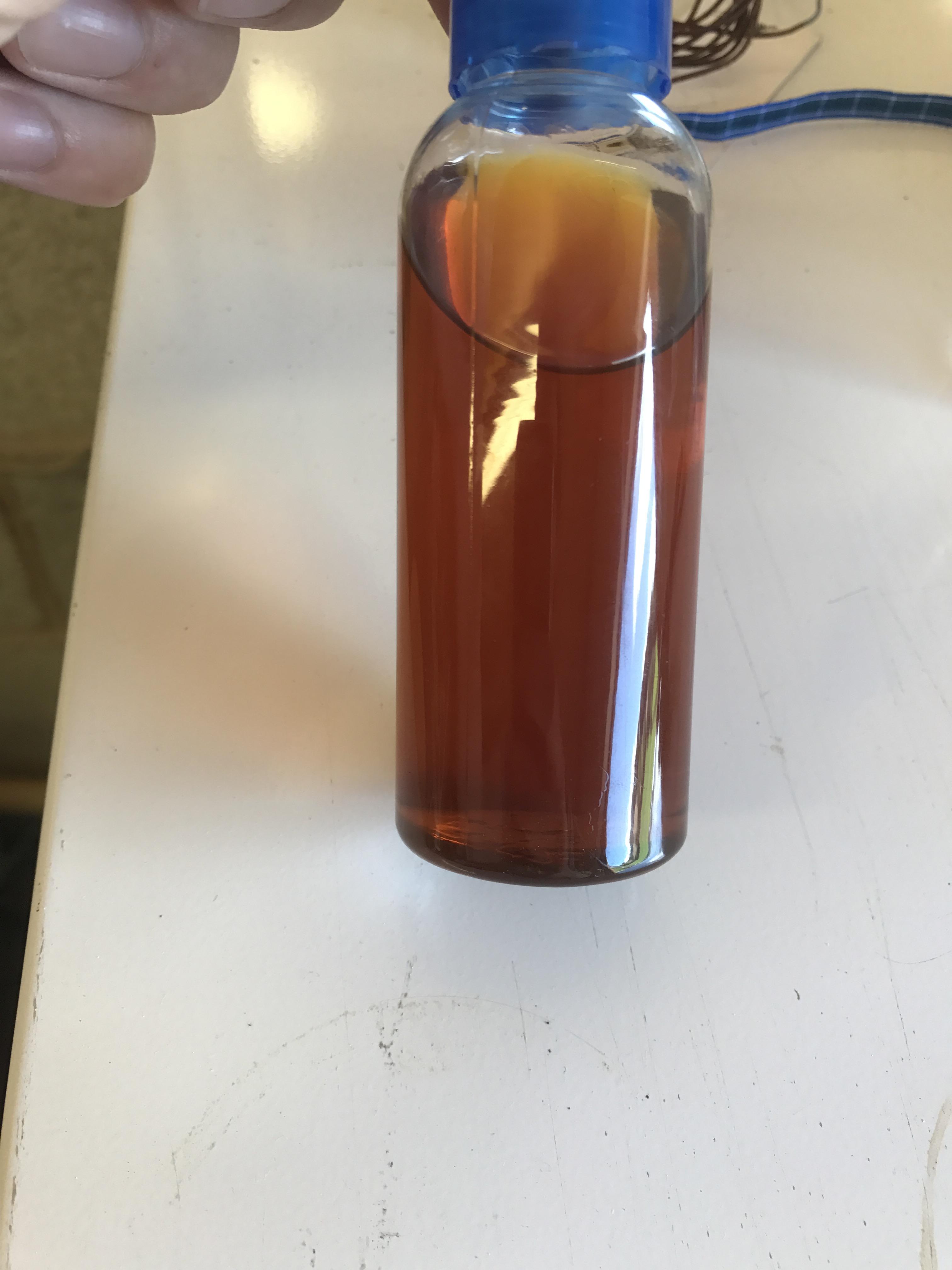

Re: Citroen C5 - Changing LDS fluid
The LDS should just about be visible when on low at the bottom of the 'basket' you describe in the filler of the tank.
Here is some LDS:
I'm not au fait with the smell of power steering fluid so I can't help on that front but if in doubt then replacing the fluid will do no harm.

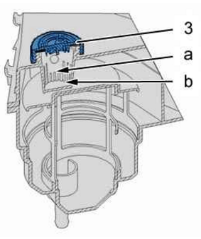

Here's the procedure for a MK II Drain and Refill:
Remove:
Uncouple the hose ( 2) from the LDS fluid reservoir.
Drain the LDS fluid reservoir.
Refilling
Connect the hose ( 2).
Refit:
Open the plug ( 3).
Add LDS fluid until the level is between the minimum mark "b" and the maximum mark "a".
Bleeding
- Start the engine.
- Place the suspension height control in the "LOW" position.
- Stop the engine.
- Raise the vehicle and support on axle stands, wheels free.
Remove:
- The front right wheel
- The front right mud guard
Refilling
Refit:
- A new clamping collar ( 1)
Open the plug ( 3).
Bleeding
- Apply a pressure of 0,5 bar in the LDS fluid reservoir (using a FACOM 920 tool).
- Start the engine.
- Wait for the vehicle height to stabilise.
- Place the suspension height control in the "HIGH" position.
- Turn the steering from lock to lock in each direction.
- Stop the engine.
- Check the LDS fluid level.

Should the car be put on axle stands only on the right side? (Only the right side which is lifted up)
Why do I need a new clamping collar (1)? (Can I not use the old one)

- x 2941
The hose No2 in the picture has a join at the bottom which is easier to separate than the one (No 1) at the top, the hose can then be dangled in a bowl on the floor to save getting drowned in oil.
You would only need to remove No1 if you were intending to remove the reservoir.

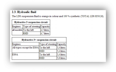

Does anyone know how much LDS oil is needed to fill up the tank after draining?
411514
- (Donor 2017)
- Posts: 423
- Joined: 14 Dec 2010, 15:26
- x 40
No, I don't. I would guess however at about 2 litres. In the UK at least LDS can be gotten relatively cheaply, so if I were you I would buy 3 litres and I should imagine that will be plenty.Cupi34 wrote: 18 Jan 2018, 15:54 Does anyone know how much LDS oil is needed to fill up the tank after draining?
Sam
2003 C5 2.0HDI 110
2003 C5 2.0HDI 110
- x 2941
This do?
- Posts: 28634
- x 5648
When all mine leaked out I put 4L in and it wasn't enough.
