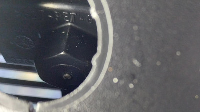

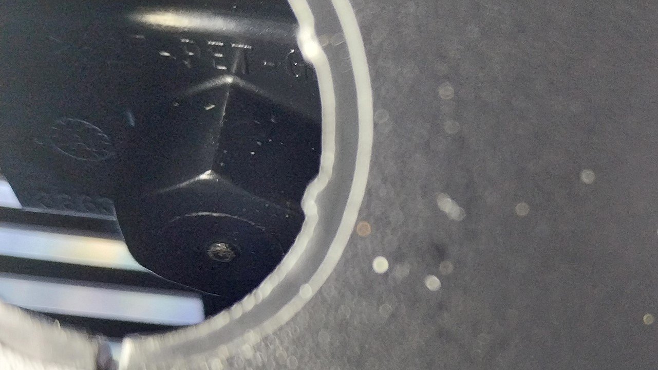

Being a veteran van driver, one of the tricks for safely emerging from awkward sharp T-junctions, was to fit a rear view mirror and set it to see out the offside door window. And OK, I know a panel van doesn't need a rear view mirror but was usually set up to accept one because the same van was often available as a "combi" or minibus. When I approached my dealer to buy a rear view mirror he said my Dispatch hasn't got a mount beneath the blanking grommet. However, on examination I find it has a square lug, which looks like its waiting to have a mirror pushed onto it. So, my question - is there such a mirror? And who can I buy one from?
(It's a 2025 74 reg Dispatch M)

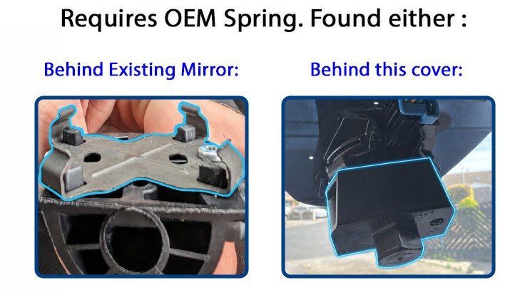

The square lug turns out to be a hex lug, and according to a reversing camera site, it's a cover, which can hopefully be removed (anticlockwise?) and the correct mirror fitted (turning clockwise?) into a sprung plastic socket behind. So, I suppose the hex lug is to enable the cover to be rotated and removed. I am waiting for my dealer to confirm. Part no. of mirror seems to be 98103612XT. I will update this topic as soon as I get an answer from the dealer.
