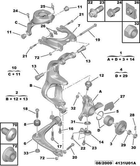

The one I would look at is the Frip joint, "normal checks" (because HA suspension) hide the wear/seal failure. (pry bars etc)

Raise the wheel, pry-bar into the joint and leaver it, you should not see ANY movement unlike a bushed joint. The joints only have a limited life, the bumpier/dirtier the roads the shorter the life of the joint, the seal fails and you get the results above. In my case I had a little "clack/tick", I could only hear it at low seed, I could feel nothing via the steering for example. It was the dry bearings I could hear.
