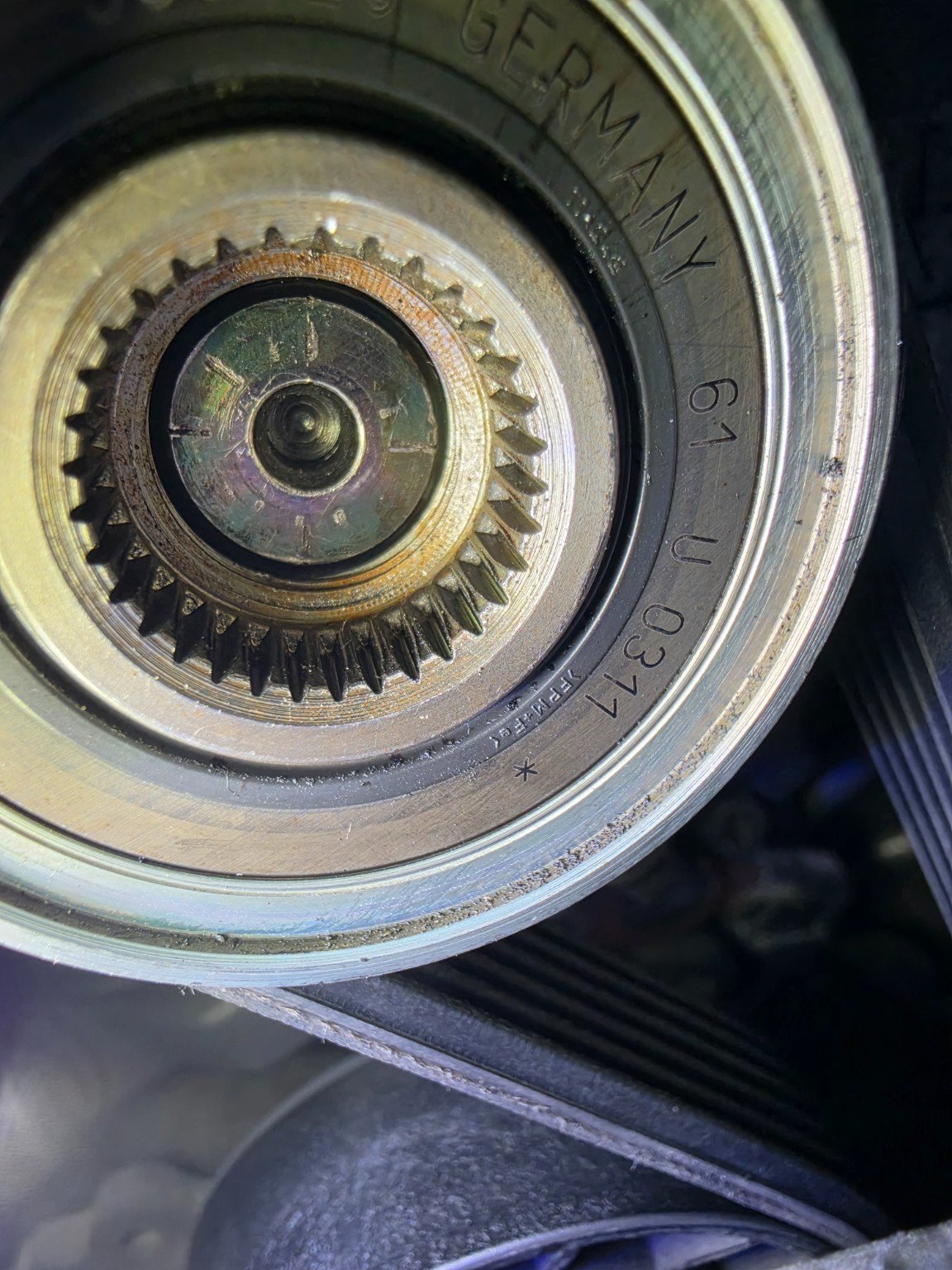

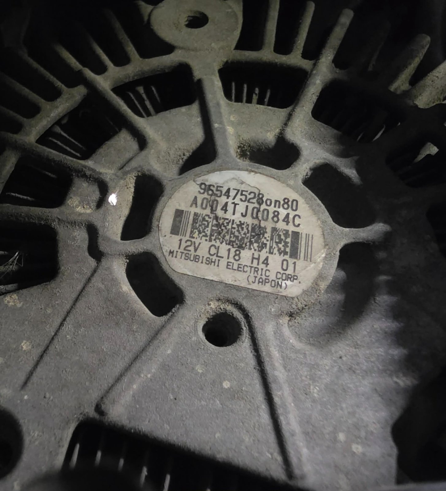

I have a noise from the alternator pulley 2.0 hdi 407 i have the socket with splines but the inner is not torx
do someone ever remove a pulley like this?
Posts: 21393
x 8165
Re: 407 alternator pulley
You could try the normal removal method as shown in this video where there is a torx socket, but hammer an oversize torx or Hex bit into the end of the shaft. However hopefully someone who knows the correct procedure will offer some advice. :)
