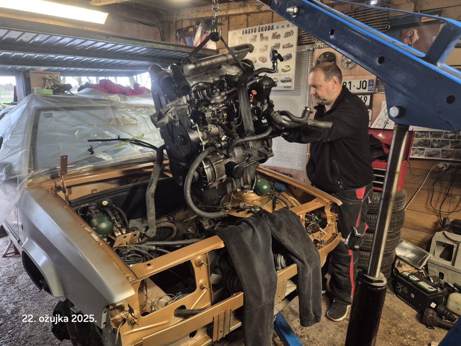

i have a 1987 Citroen BX 19TZD Turbo with a XUD9 DHY engine from a second gen Peugeot 405.

This is giving me some assurance that its probably a healthy engine then, i replaced the stock A8A engine (XU7TE) because the car sat for 18 years before the restoration and the headgasket gave out (mixed oil and water under highway driving).
