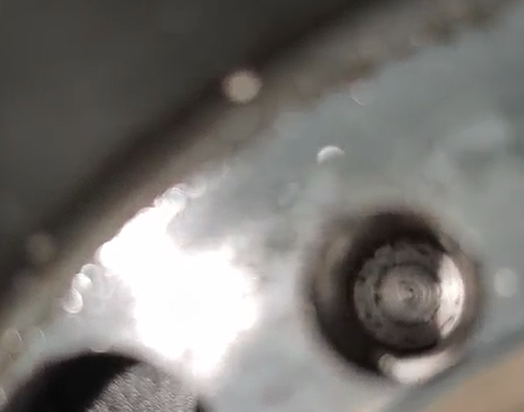

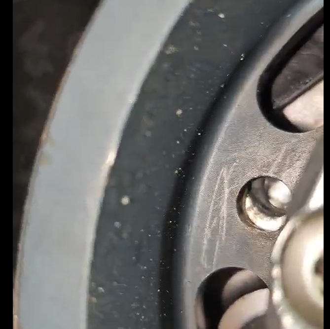

my friend said that on intake cams you cannot set it exactly as it should be since those engines do not have adjustable cam gear comparing to ES9J4S (I attached pictures how they were set comparing to marks)
DAYCO was used: https://motostacja.com/p/155053.html

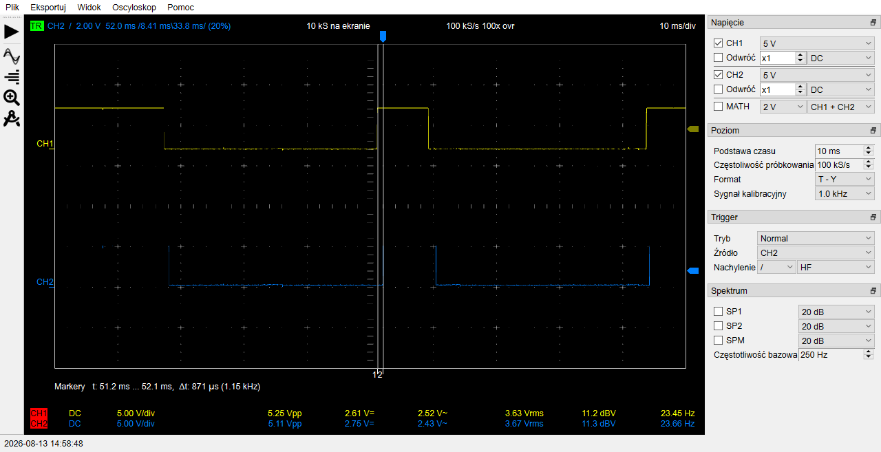

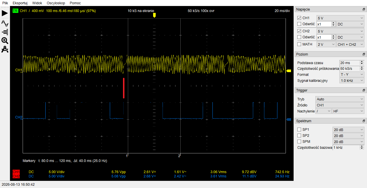

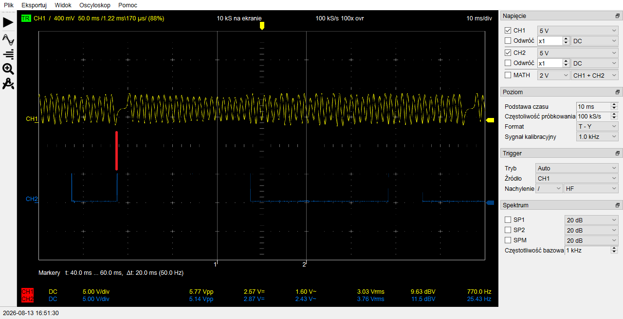

-We check the signals from sensors (crankshaft + camshafts sensors) to ECU - they seem to be fine.
-We check the signals from sensors using oscilloscope however we lack knowledge if it can be an issue - it seems like rear camshaft is late (Camshaft angle offset) ~2 degrees comparing to front camshaft sensor data.
I attached images - seems that in exported images we have issue with high voltage but it was there in actual software (just missing in pngs).
CH1 is either crankshaft or camshaft front (Depends on image)
CH2 is always camshaft rear
Whenever P1335 is deleted it comes back after few seconds or minutes of idle or riding
VVT solenoids stop working at some point + crankshaft/camshaft synchronization says NO in the program, camshaft stays fluctuating around 35-37* and the P1335 is back.

-We scoped it again. The waveforms haven't changed much, but this time I got much better quality captures — attached. I've also gottwo documents that may help:

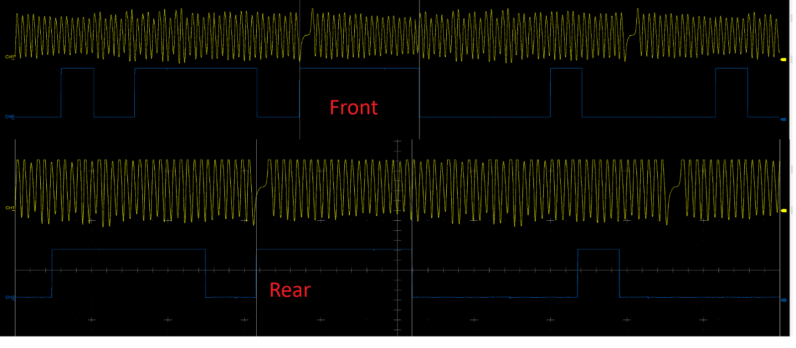

-And a link to what looks like a correct waveform for this engine, though I can't confirm it: https://rotkee.com/en/waveform-library?engine=2244

One guy that I was tracing on facebook group have solved the issue with P1335 by moving reluctor ring and welding it in place - which seems to be common solution. He claimed to have some oscilograph waveforms, I've reached out to him to receive them.
I will post them here if he is willing to share.
