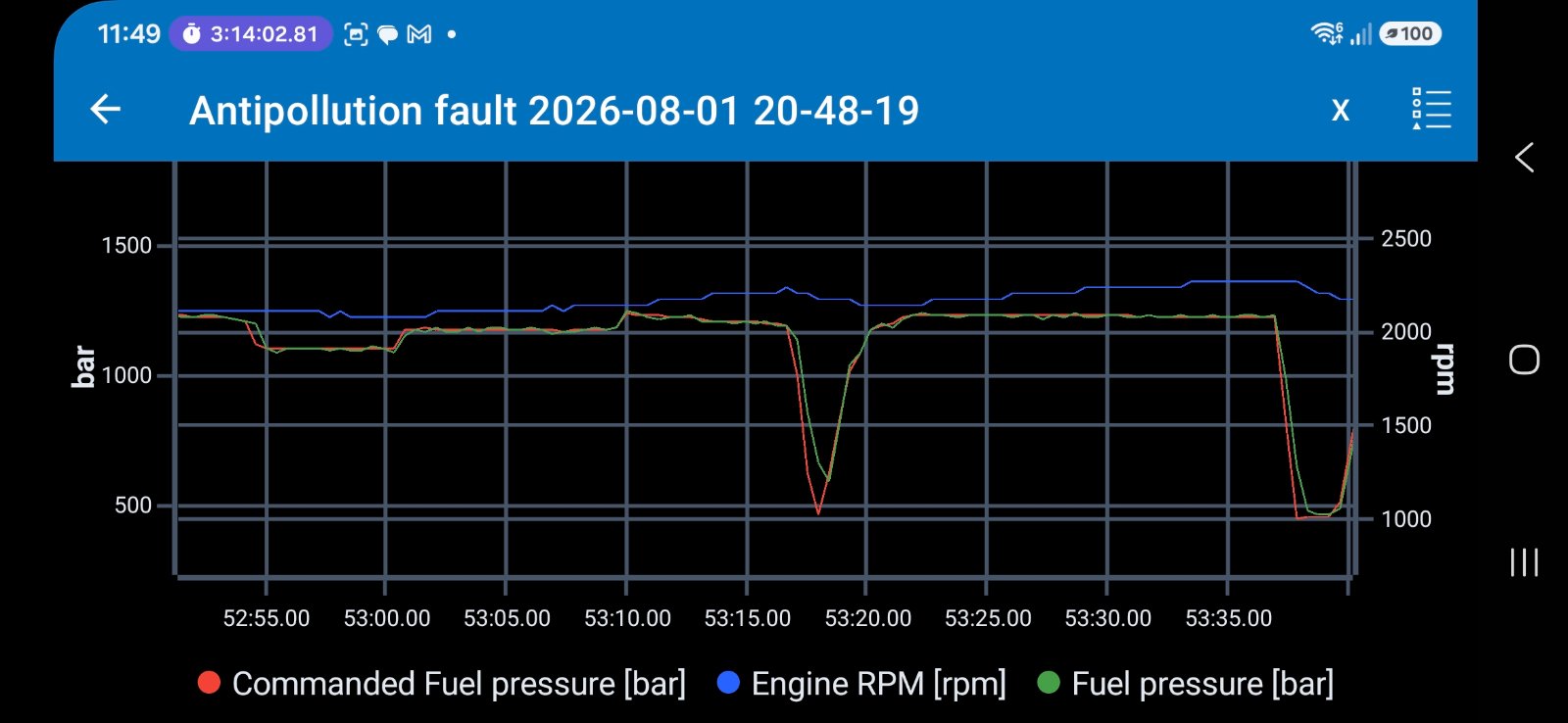

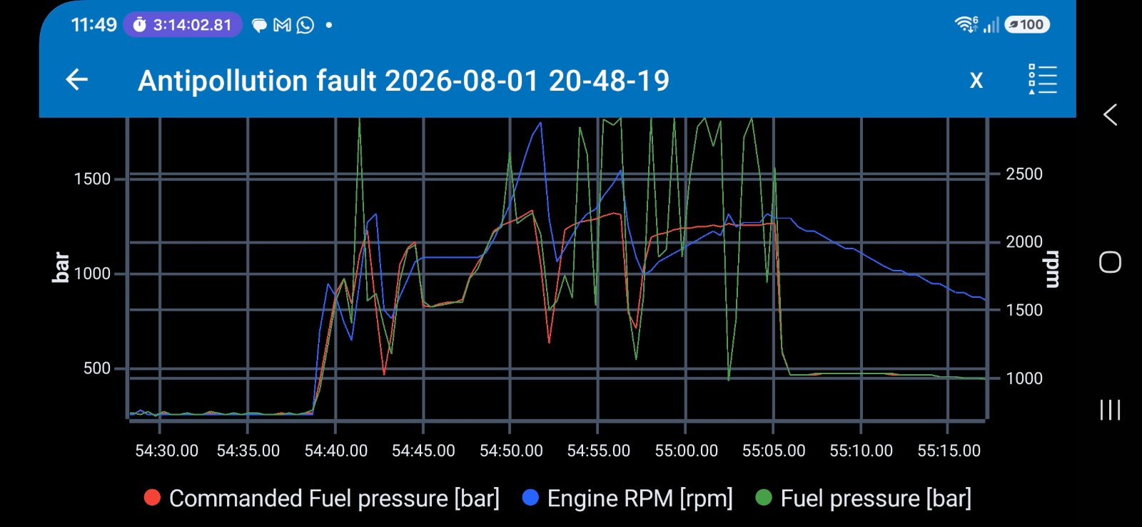

I bought a basic obd bluetooth scanner and connected it with an app and have been able to monitor what's going on when this fault occurs. What seems to happen is that before the fault occurs there are large discrepancies between the readings for 'fuel pressure' and 'fuel pressure commanded'. 'Fuel pressure' shoots up suddenly to a max reading of 1824 bar while 'fuel pressure commanded' stays in the normal range.
