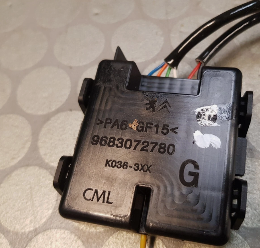

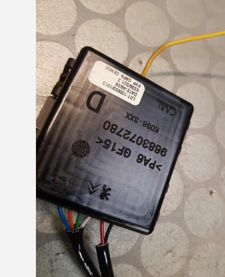

I have a Citroen C5 2014
I started having a problem after I connected the LED lamps in the door trim with the original Citroen boxes according to the manual
9683072780
Is there anything I can do to prevent this problem from appearing? Maybe a diode resistor or something? Any ideas?

Whenever you replace standard lamps with LEDs you usually have to connect a balancing resistor in series so the unit presents the same load to the ECU which keeps it happy. Your supplier of the LEDs should be able to give the the details of the resistor required. :)

I would be happy to explain what it is supposed to do. Is there a resistor inside this original box that is compatible with the system?
Because the video of the guide doesn't say anything about adding a resistor.
