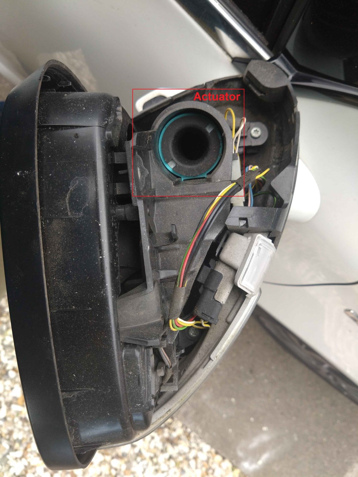

Taking the mirror apart
I followed this C5 mirror actuator video, which was actually pretty close for the C4 Picasso Mk2 mirror:
https://www.youtube.com/watch?v=0O-UsXH6FS4
Mirror actuator placment

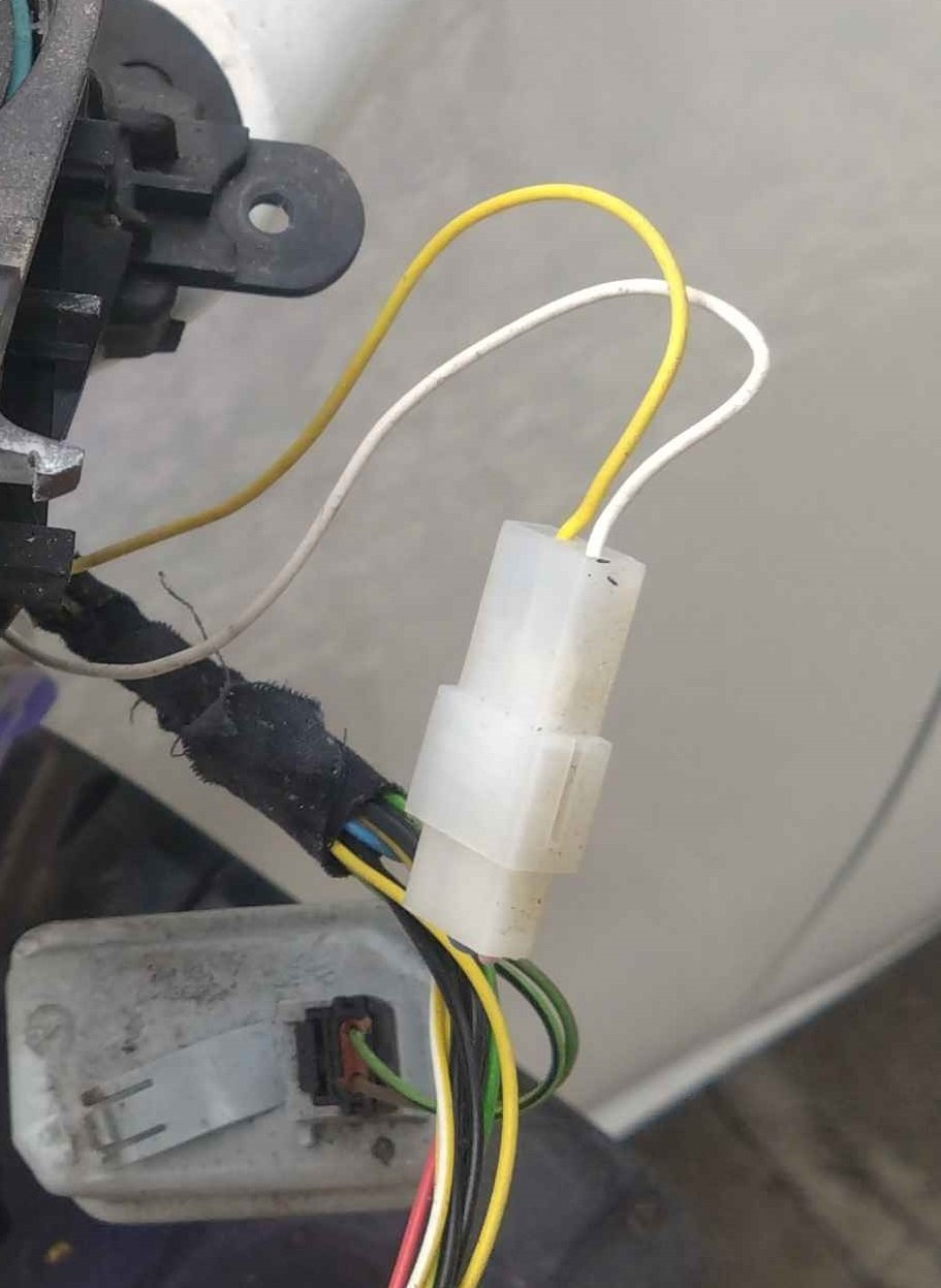

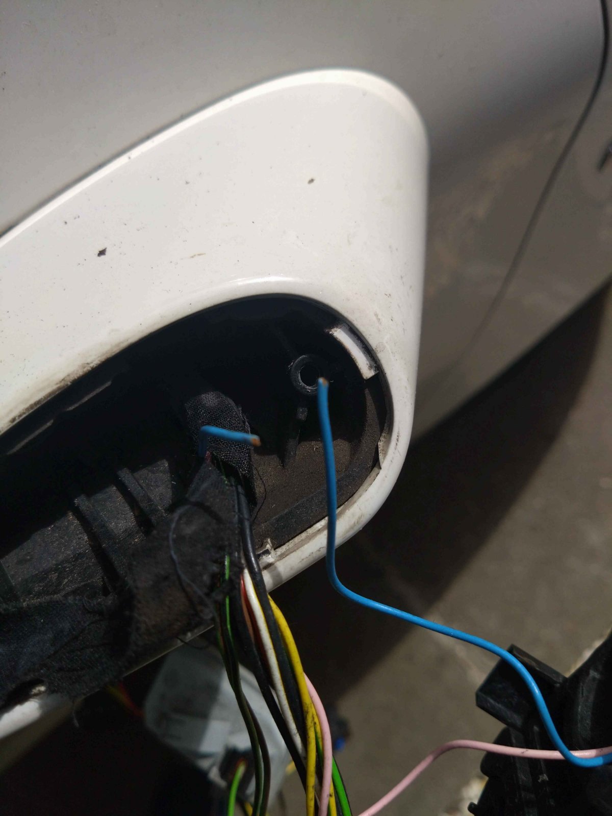

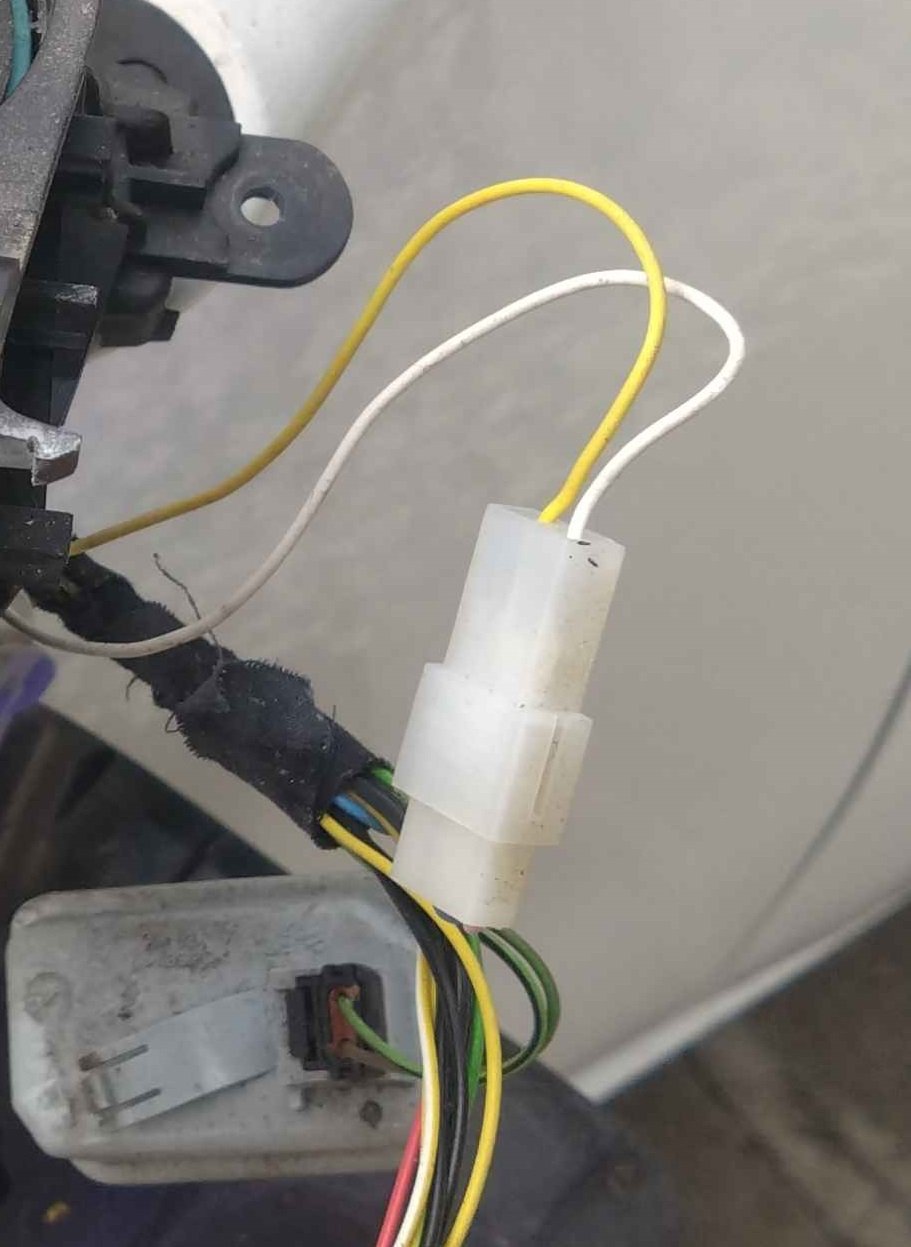

My actuators power cable:
Getting into the mirror housing itself was fairly straightforward. The nightmare was getting the actuator out of the mirror housing. It took about two hours of swearing before it finally moved. The actuator is held in under tension and is not what I would call service-friendly.

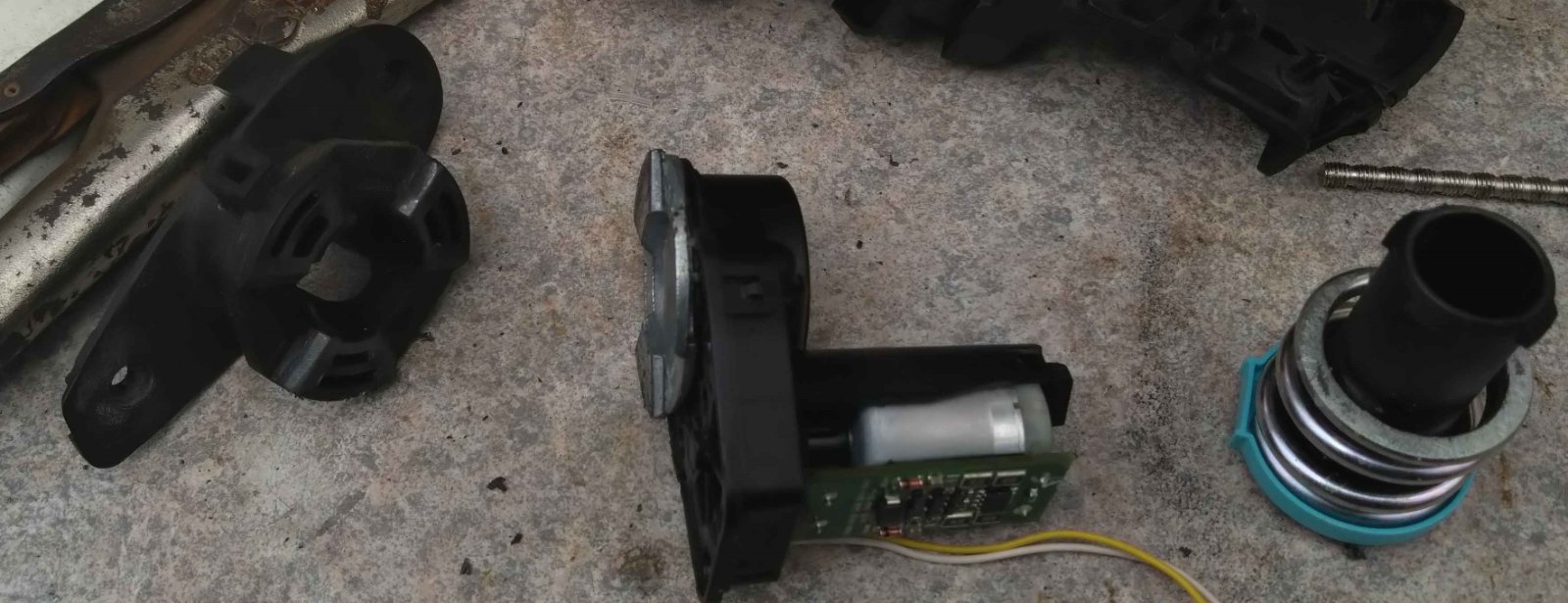

Actuaor removed:
Problem 1: wrong connector
One thing I noticed immediately was that the motor connector on the replacement actuator was wrong. In hindsight, I probably should have stopped there.
Instead, I thought I could swap the connector or splice my way to a working mirror.

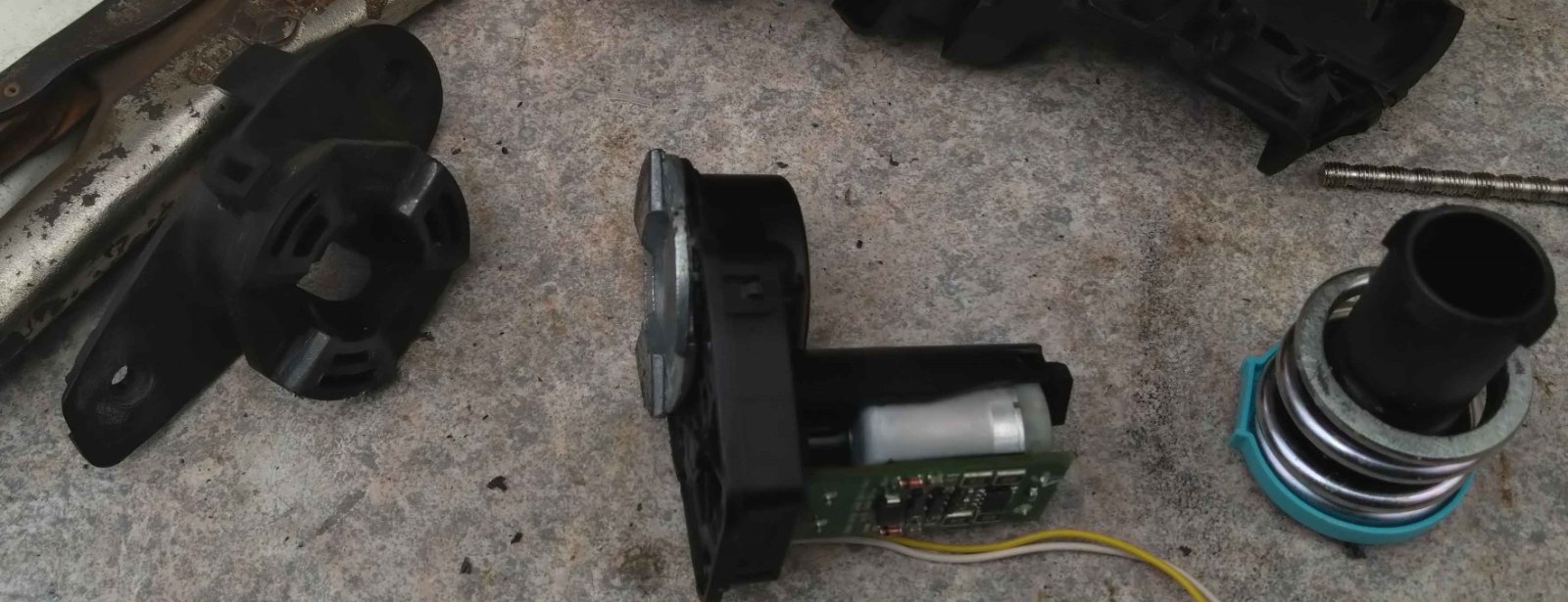

Problem 2: the actuator was not actually the same
Once I finally got the original actuator out, it was obvious the replacement was not the same part.
The replacement actuator was different in several ways:
  • different size
  • different connector
  • different motor
  • different internal gearing
  • different actuator housing layout

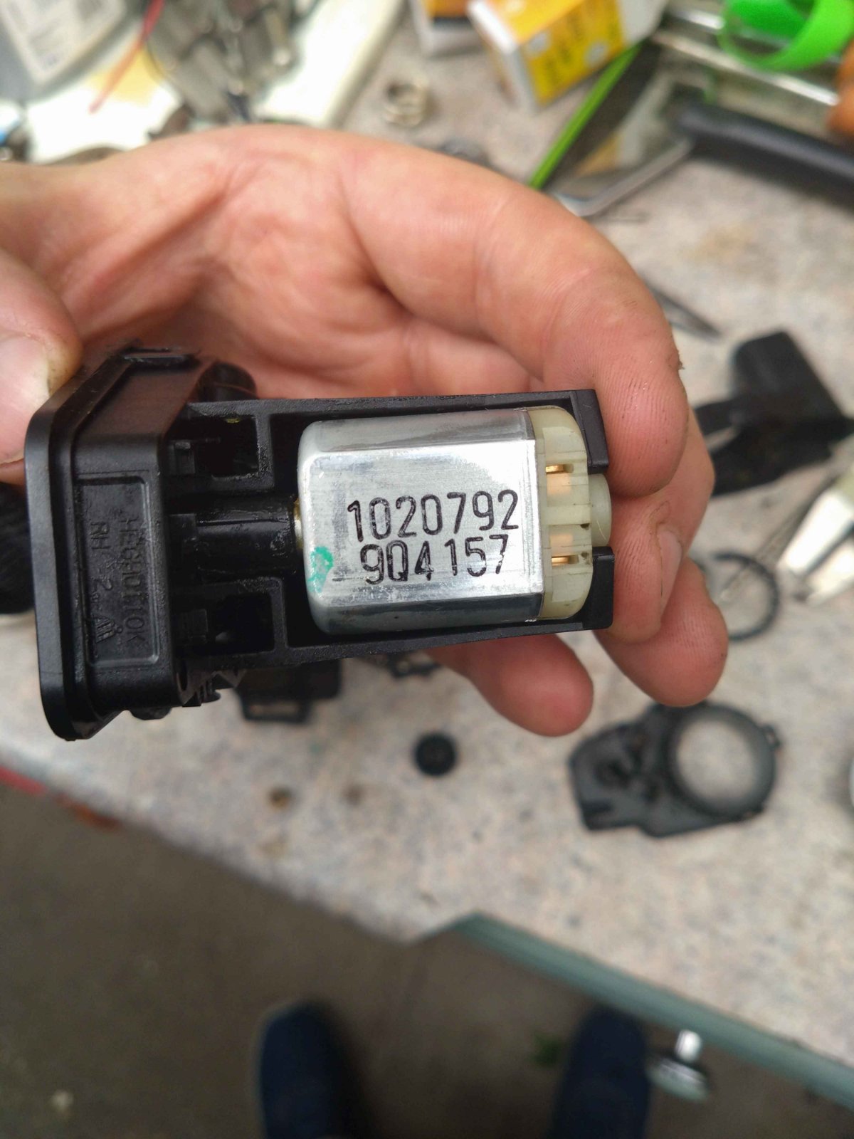

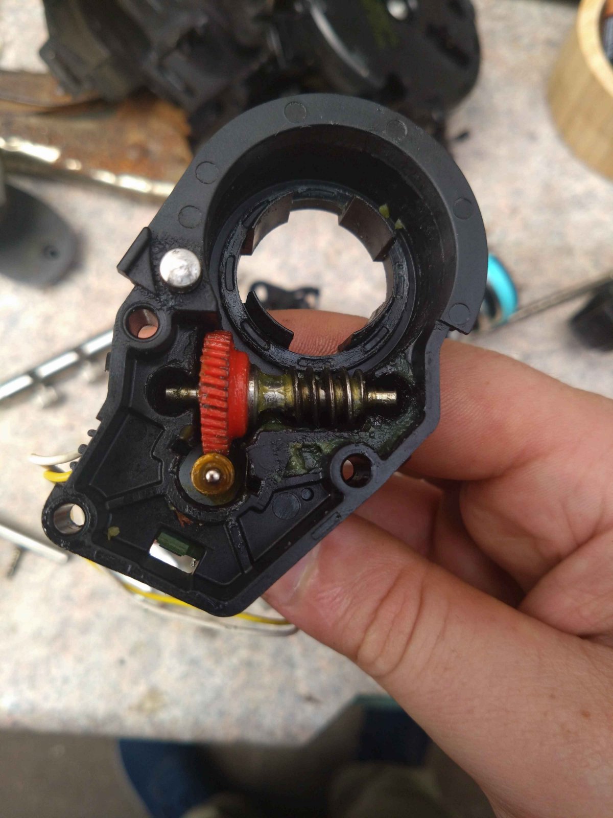

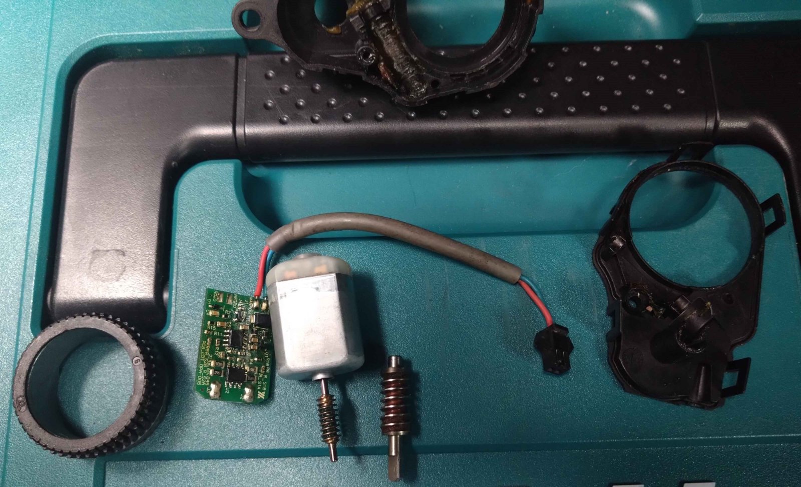

My Actuator:

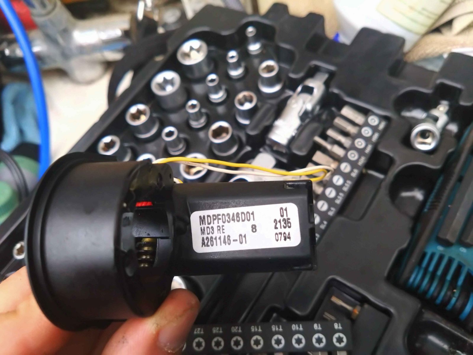

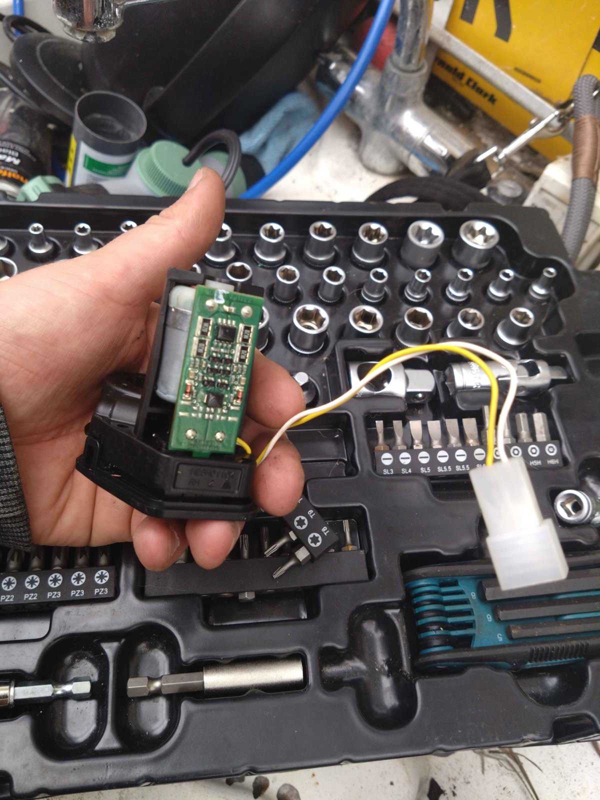

Replacment Actuator:
Motor: FC-280SB-16220
The replacement had a black gear instead of the red gear in mine. It looked similar to the actuator in the C5 video, but I dropped the gear and it has now disappeared forever.
You can swap the power connector between the two. I tested this and it did work. However, that does not solve the real issue: the replacement gears/motor assembly do not fit properly into the original actuator housing that fits my mirror.
So even though it was sold as a C4 Picasso Mk2 actuator, it was not usable for my car.

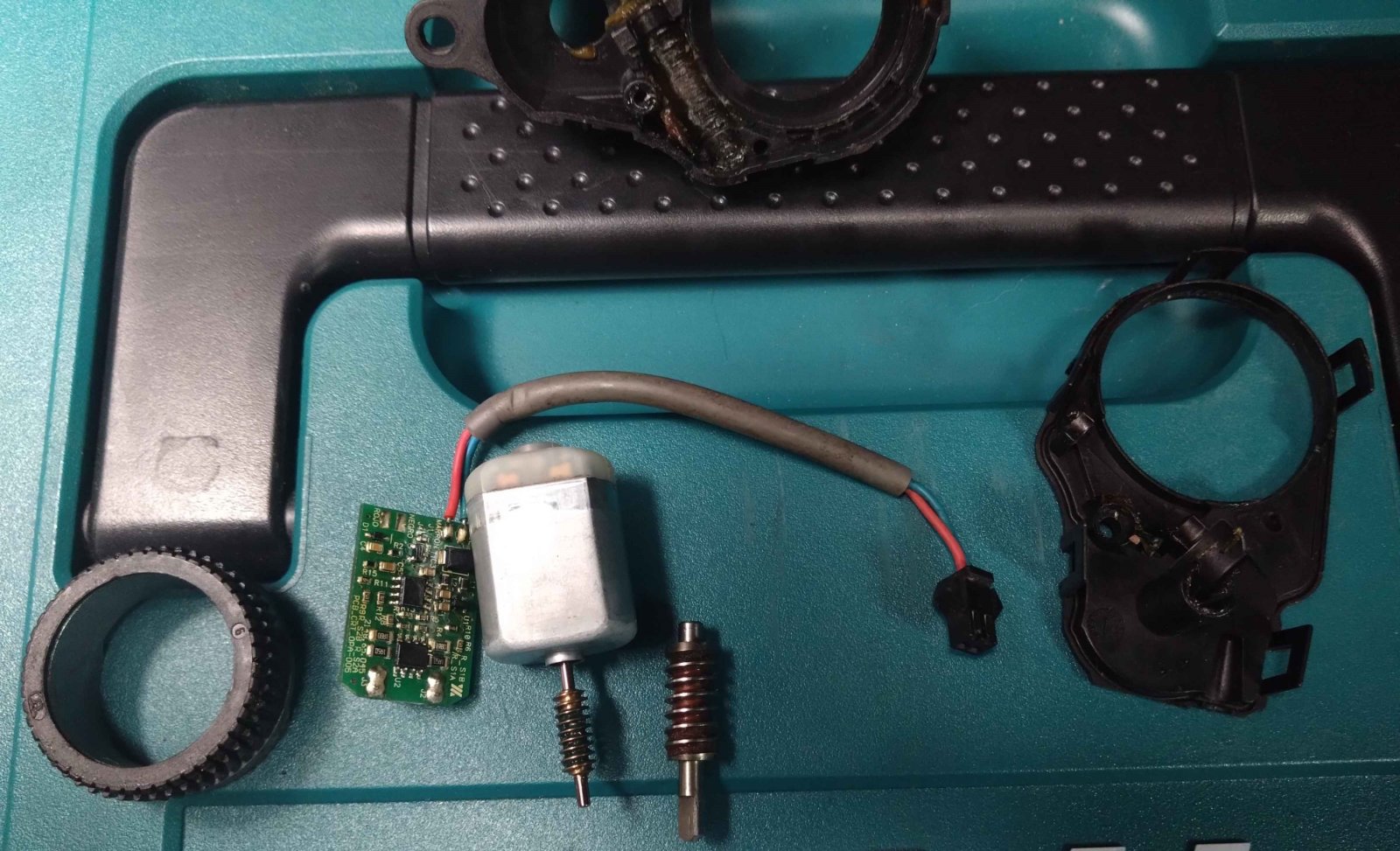

What I found inside the original actuator
The original motor still worked a bit, but not properly. With the lid off the actuator, the motor/gears would move. With the lid back on, it would bind or stop.
I re-greased the mechanism, and it improved slightly, but the internals did not look great. The gears were engaging, but they looked somewhat worn, and the motor felt weak. So there was definitely something wrong in the actuator, but I am no longer convinced it was the only fault.

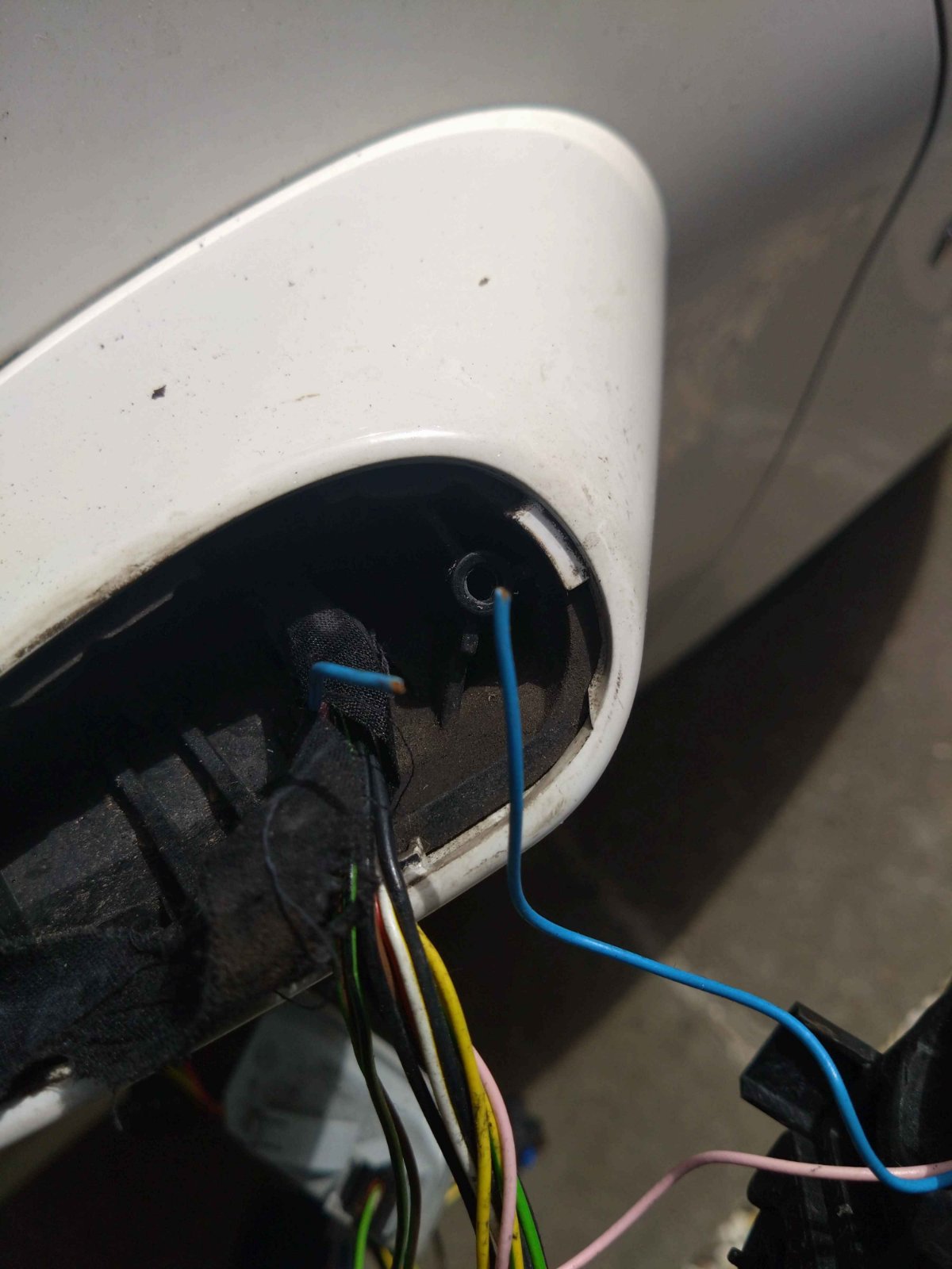

Problem 3: wiring inside the mirror/loom
When I was putting the mirror back onto the car and reconnecting the wiring, one of the power wires to the folding motor snapped clean in half.
It reminded me of the ABS wiring loom issue, except this did not look crusty or water-damaged. The loom tape inside the mirror area looked old and tired, and the wiring had definitely seen better days, but there was no obvious water ingress.
I soldered the broken wire back together, rebuilt the mirror, tested it, and it still didn't work.
That could be because my solder repair was not good enough, or the cable was not in great condition, or that the actuator/motor itself is also faulty. At this point I am just buying a new mirror, a cheap damaged one on eBay, then using the housing of my mirror over it so it looks nice.
