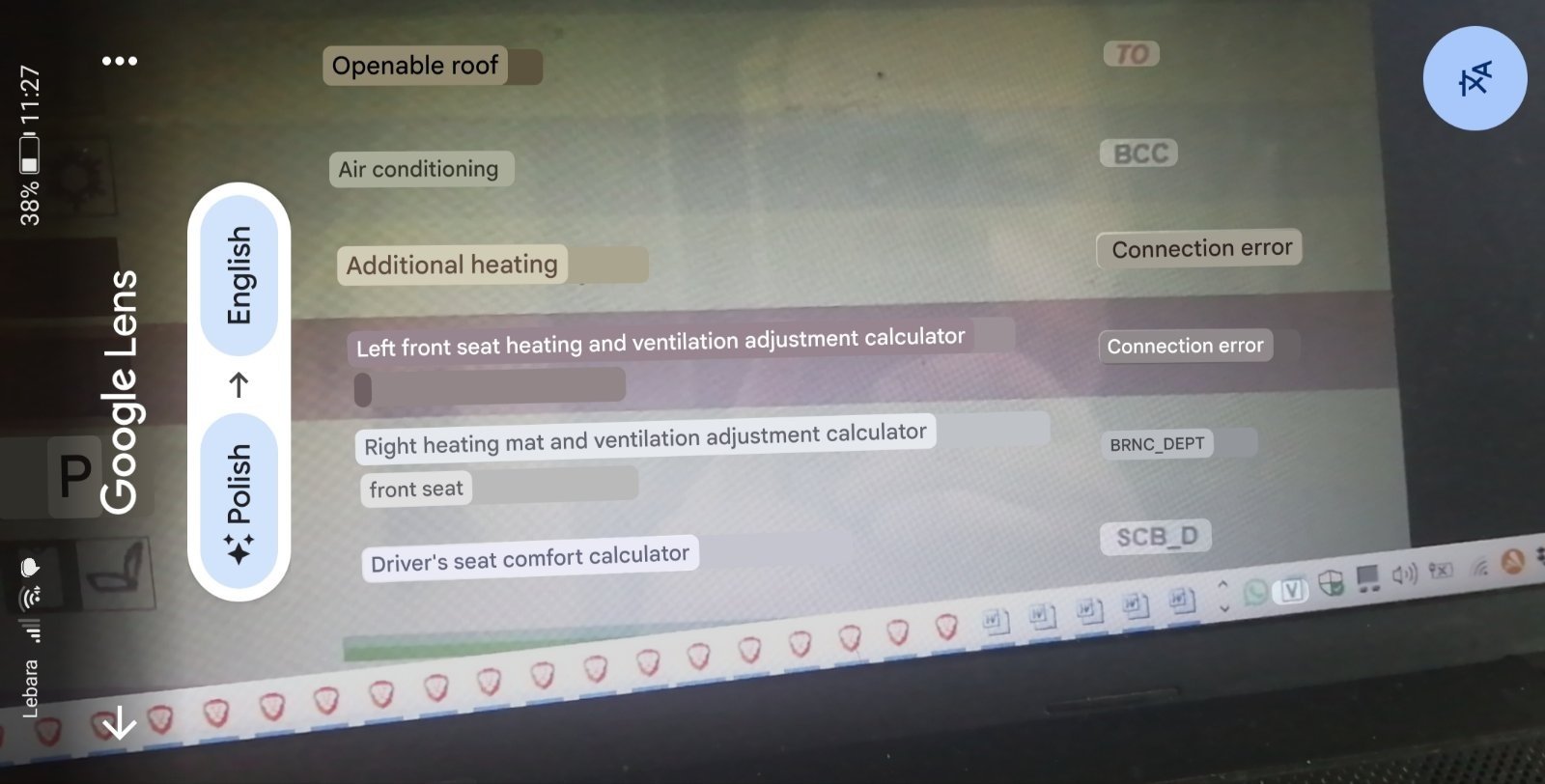

With you. Diagbox won't connect to the seat. How do I turn on the seat heating? The seat mat doesn't heat, but the backrest does. Has anyone had this problem and knows where to look for the problem?

If you post a translation of the fault screen you will have a better chance of help

If the backrest heats but the seat mat doesn't it sounds to me as if a wire within the seat mat has broken which is not uncommon.
I may be wrong but both (back &seat) recieve a signal and power at the same time from the ECU.
I would check continuity on the cushion pad,

Niechlujny I also suspect that the mat is broken, although I don't know why there is no communication with the left seat controller. There should probably be an error regarding the mat.
Paul R thank you for translating the photo.
maybe someone has diagrams for this chair?
