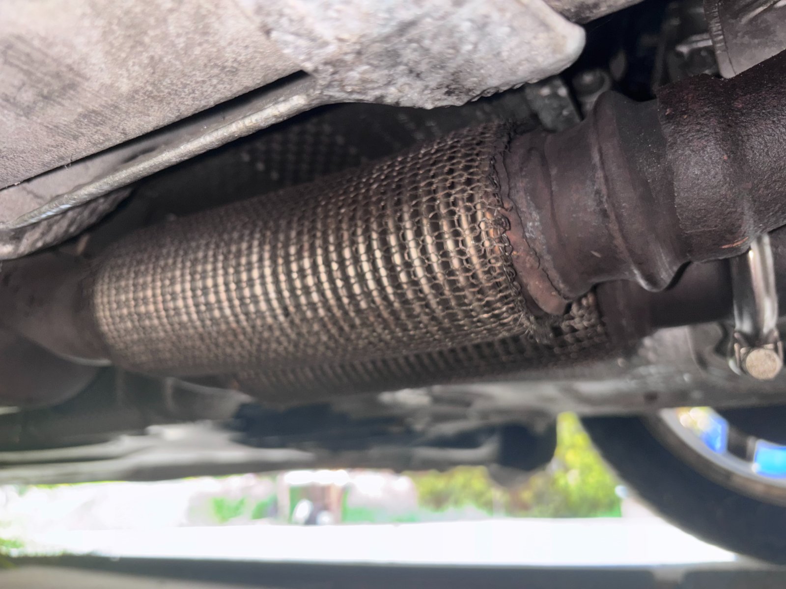

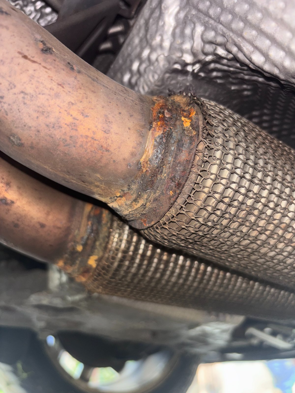

There are a couple of bits that need attention before I dare to show up for the rather strict inspection and bureaucratic vehicle registration process. The main one now being is the car has an engine light with the "anti-pollution system faulty" message. Knowing the exhaust flexible pipes are in pretty rough shape, I assume that is the main problem - see the pictures below.

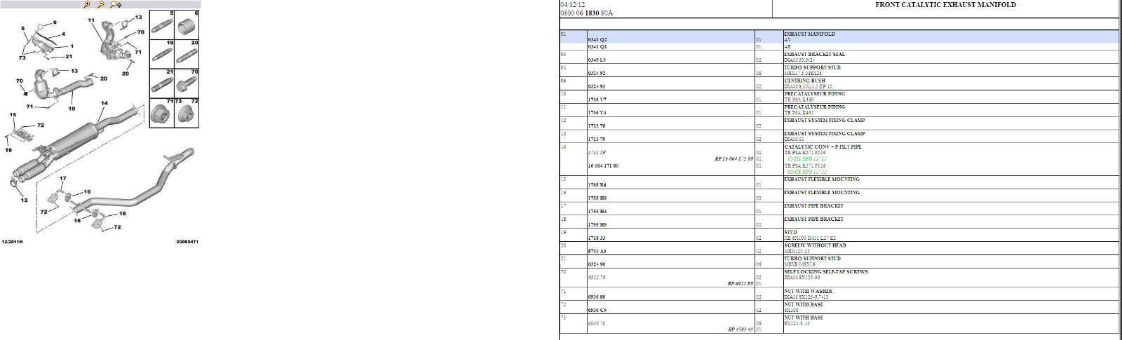

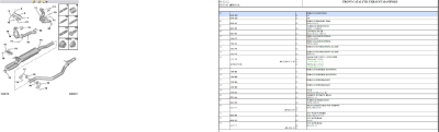

I've been digging through the old service documentation and the diagrams to try and find parts number for this part. I'm not counting the hours I've spent on this, also reading through this forum, searching on carfrance24 and various other parts sites. I now have two final options - searching around scrapyards around me and/or FB to see if someone happens to have a similar model, though these flexi hoses may not be in any good condition either, or, hoping any of you guys have experience with exhaust jobs.
The relevant diagram of course names all of the bolts, clamps etc, but the part I'm looking for is not listed.

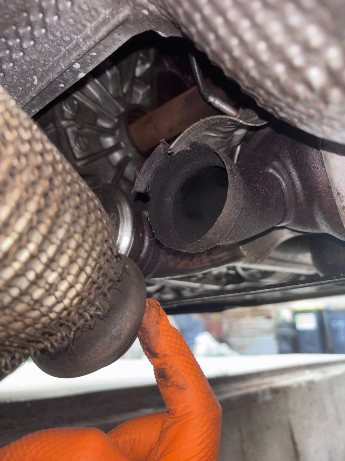

Yes I'm aware that the catalytic's end is also damaged - I'll cross that bridge when I get there.
