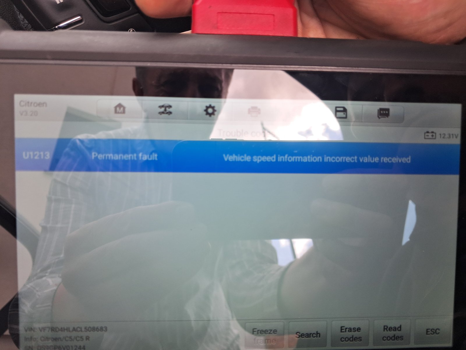

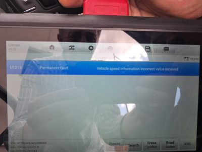

One fault message appeared while checking my Citroen C5 at a mechanic.
The fault is U1213 - Permanent fault - Vehicle speed information incorrect value received
The mechanic told me it's a sensor fault.
Can anyone let me know what is the part number of this sensor, where can I order it online?
It's for Citroen C5 2012 2.2 HDI

I see at the picture, that this diagnose is not done with the diagbox.
Before you get a headache about this fault, try to find someone with a diagbox.

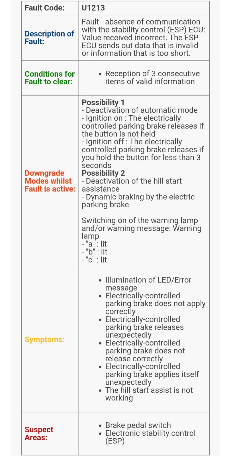

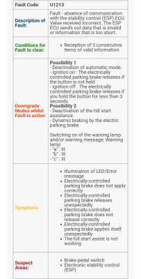

Here are the symptoms of this fault code from Citroën!
Also as you google on "Citroën error 1213" also point in the direction of an abs sensor.
