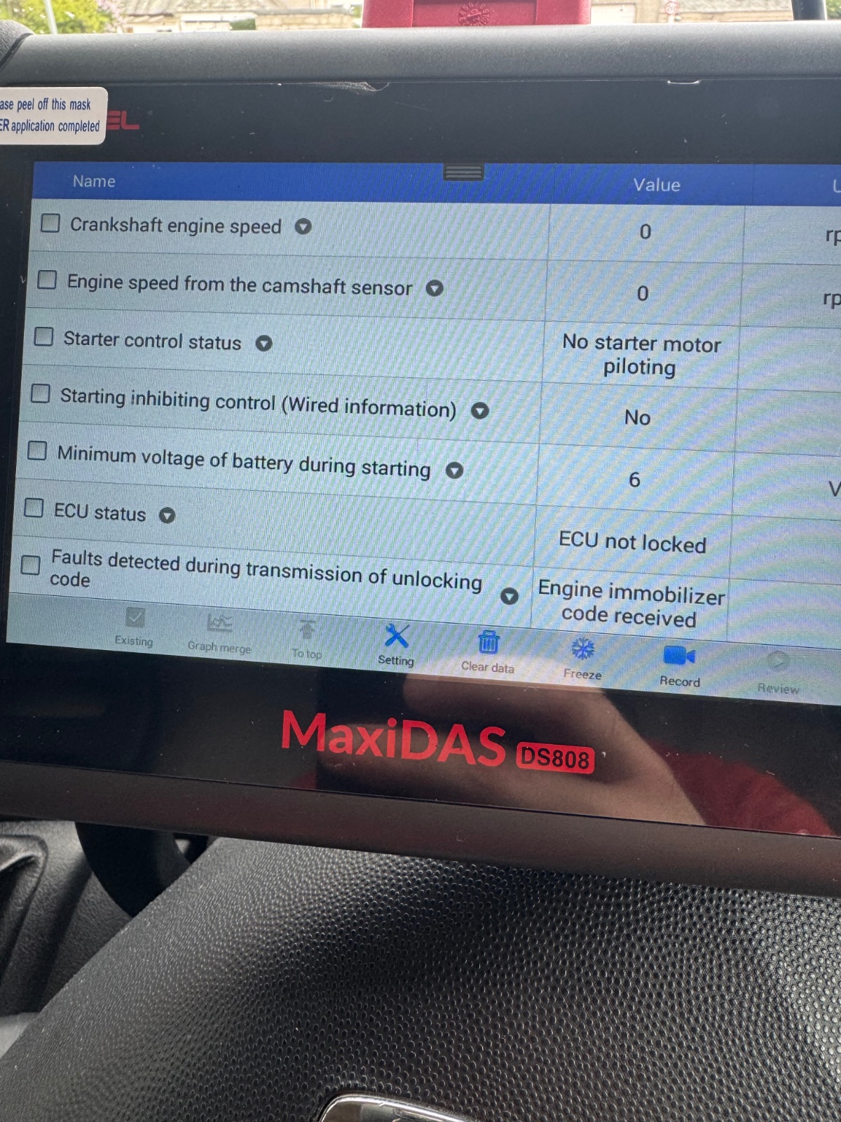

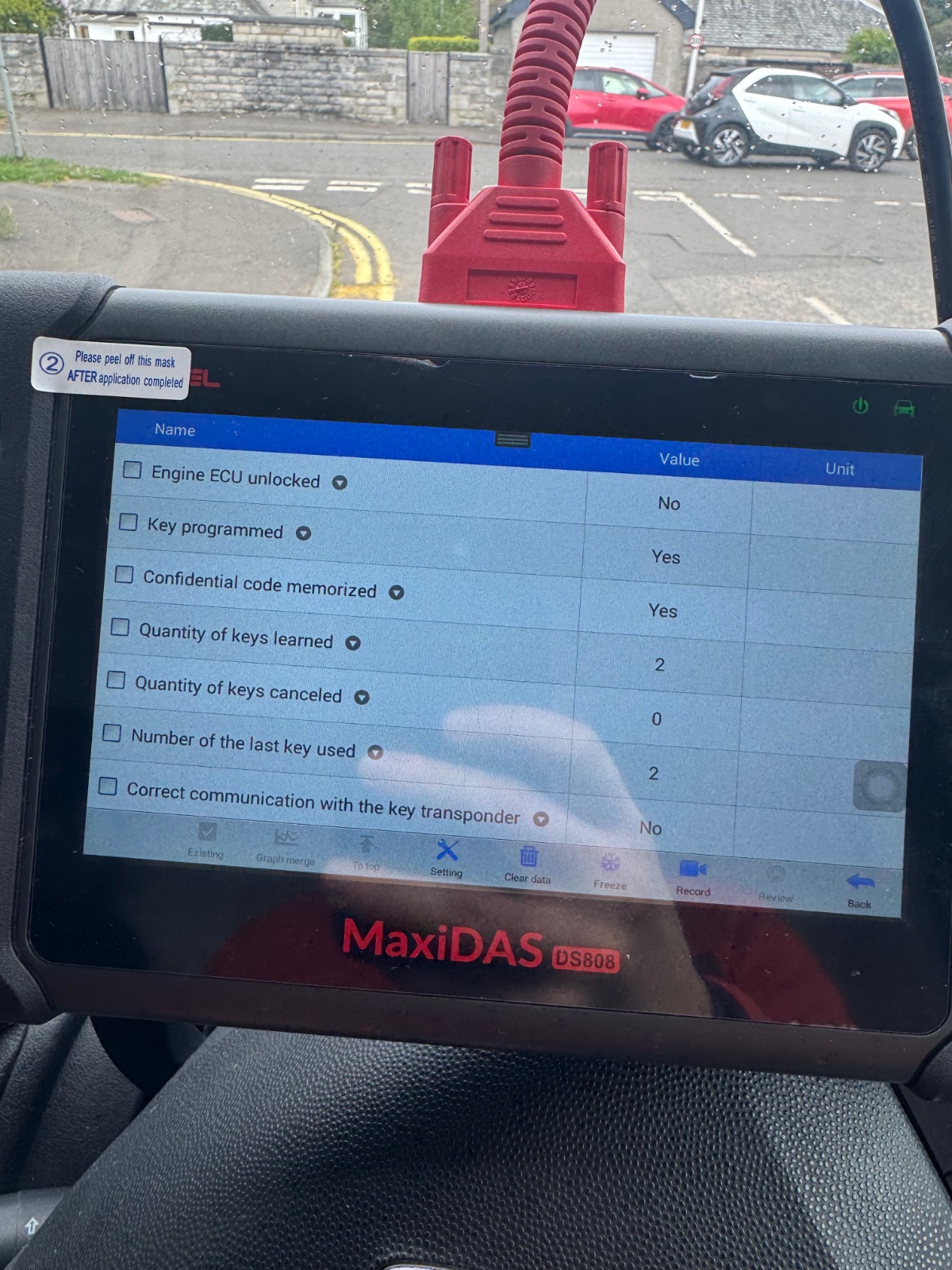

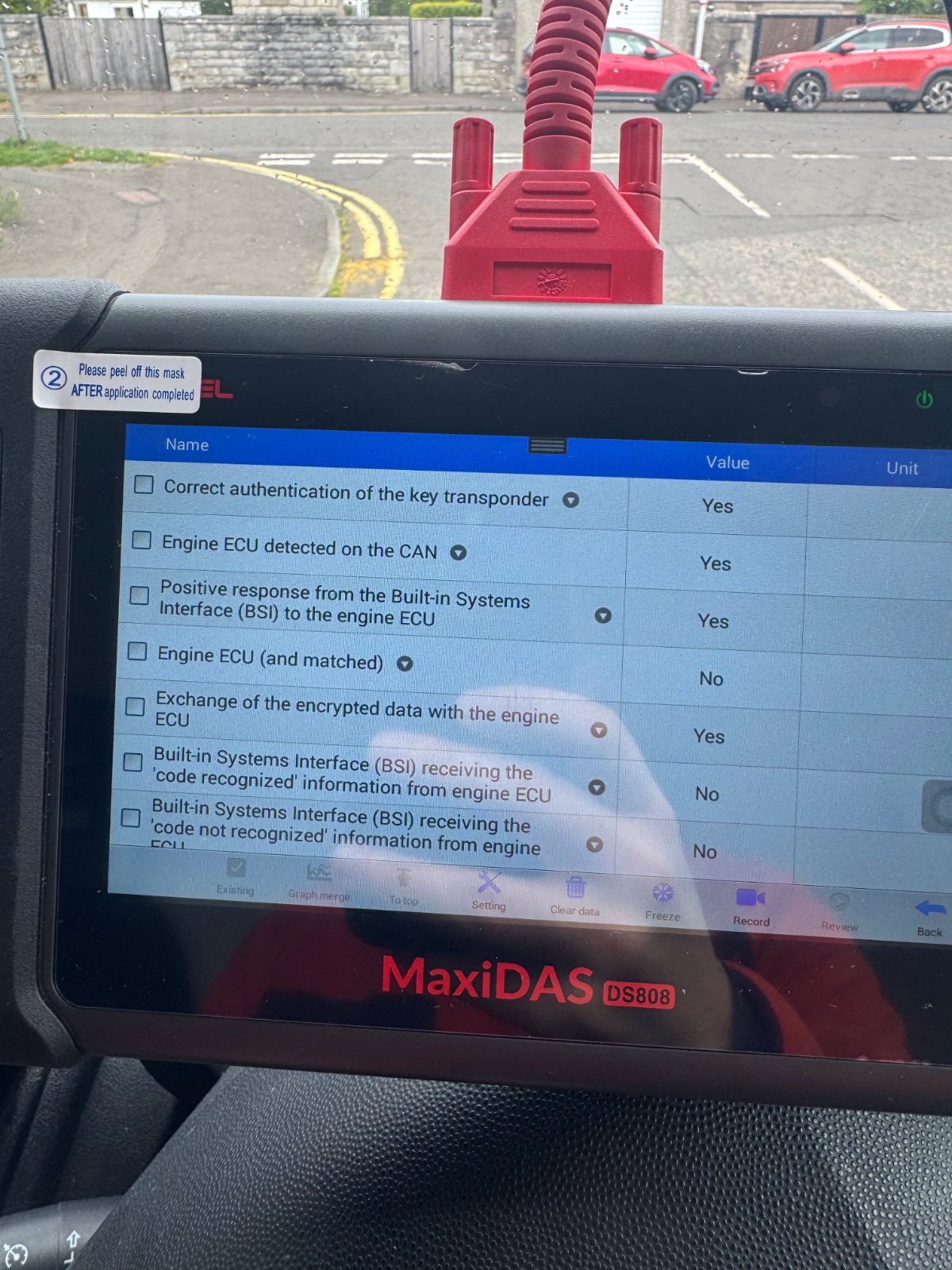

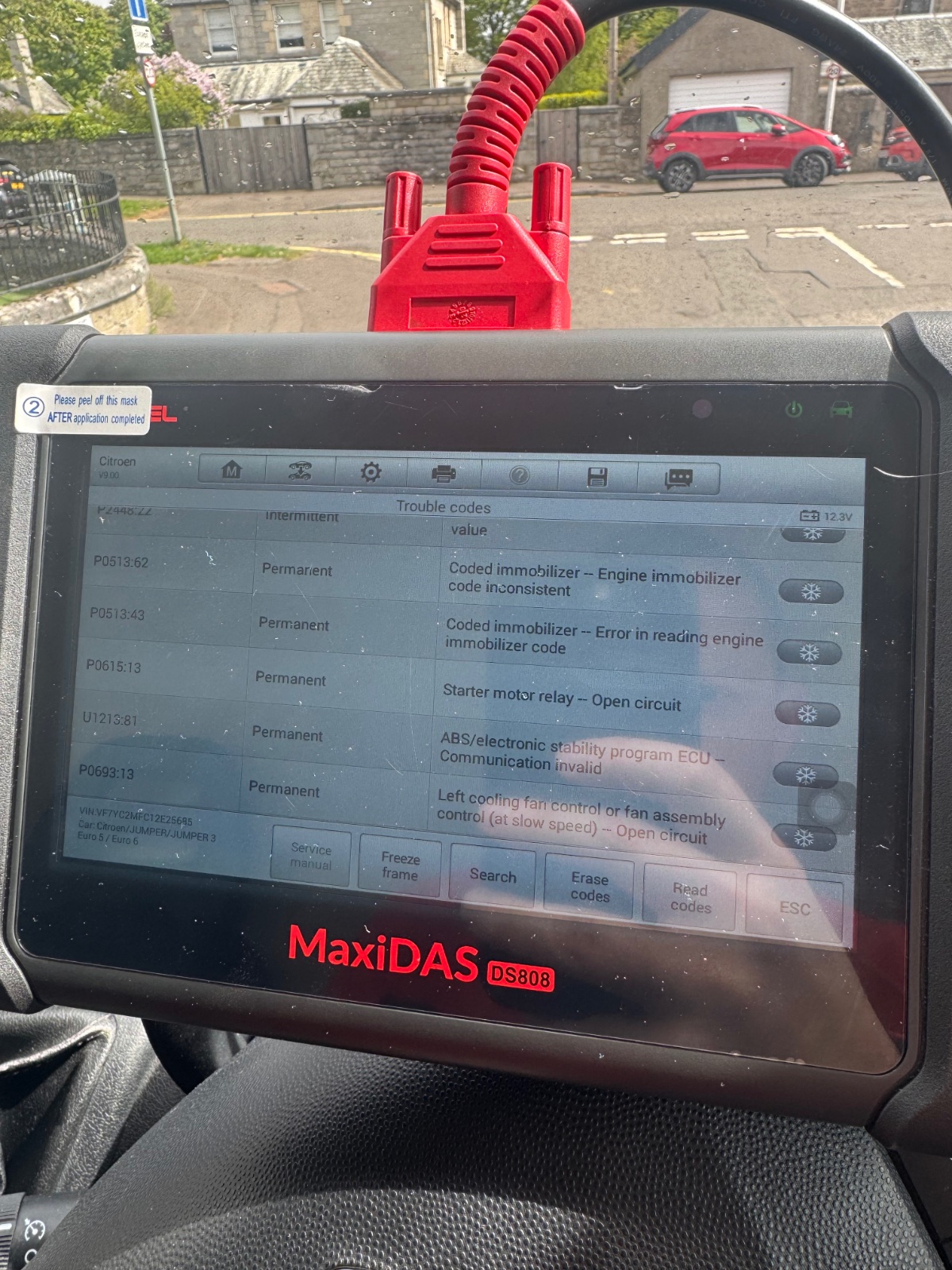

Can anyone assist with an issue I’m having with my 2017 Citroen Relay. Immobilised non crank/start. It seems the bus/ecu have lost immo sync?

I have now got the van to crank. A relay in the fuse box was installed in the wrong place. Now cranks but does not start - still immobilised on dash. Believe the BSI and ECU need to be re synced
