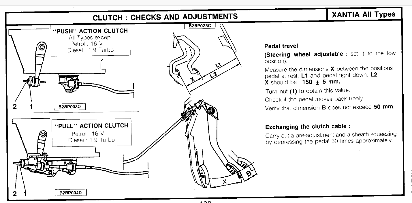

Just tried adjusting the clutch cable and both Haynes and the official Mechanics Handbook are a bit vague.
It shows both push and pull type clutches. Mine has the pull type. L1 and L2 measurements are not even shown in the Pull type picture and the pedal shaped is different for the push type which seems a little odd especially the pivot point.
I've set it by using the steering wheel dimension option L1 and L2 despite it not showing that and I've set it at 145mm. It now has some 'B' dimension whereas it didn't before. Yet to test drive which I'll probably do over the weekend.
Really don't want a snapped clip situation.
I'm left wondering if I cannot get the pedal lower because the clutch is worn. It sits probably about 50 mm. above the line of the brake and accelerator pedals as is.

Rhothgar wrote: 08 May 2026, 12:12
I'm not Jim at all sure but wheel bearings would rumble all the time presumably.
Not necessarily... They frequently hum when in the early stages of failing...
Rhothgar wrote: 08 May 2026, 12:12 Really don't want a snapped clip situation.
Nope, you don't. It's a ballache of the very highest order - especially if you're not quite as flexible as the India Rubber Man...
Just ask Alasdair....
Apropos clutch adjustment. I always adjust so the bite point feels to be in about the right place... No rocket science needed :)

Been there, done that Jim on the silver S1. 3 hour job. Driver’s seat out and lying upside down. I believe Alasdair and I share the same osteopath…
I do like the ‘feels to be in the right place’. I’d only know where that is if I’d have had one from new. I only drove car 100 miles last year, if that. Back when I got in whenever (was it 2013), it was probably alright then. My memory banks don’t extend to remembering clutch bite points of every car I own and drive. Jumping from one car to another frequently also does not help.
I can’t even remember if I’ve previously changed the cable in the green one. I’d doubt it because I’d have recalled the pain of the pedal box wrestling.
