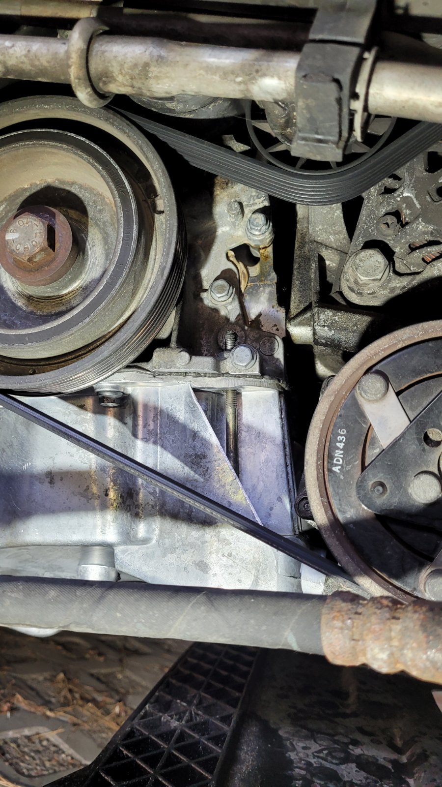

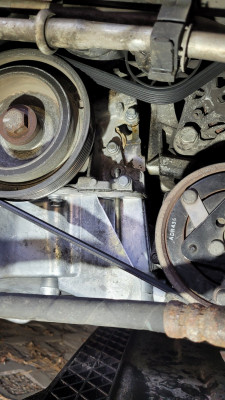

The cranchshaft pulley 0515R1 with bolt 051660
My oil pump is leaking, I suspect it is the oring 101922 and I need to take off the pulley to get in there.
Here is how the leak looks like:
