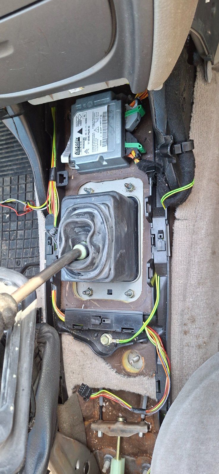

I took off the center console. It was a pretty easy job.
I checked the engine compartment to make sure the cables and their covers were in place.
I removed and disassembled the air filter housing to see where the gear selector cables were located.
I was able to move the black flat iron. Three different horizontal positions on that iron.
It was difficult to photograph that piece of iron with a phone.
However, some markings/text were found: JG24 and possibly 7649 B.
I have found a picture showing the gear selector and cables.
Is there any part in the car's chassis under the center console near the gear selector that might be broken?

The first place to look is in the engine compartment on the top of the gearbox, you should see 2 cables clipped onto levers which control the gears. It is most likely that one of the cables has popped off. You may need to remove some air pipes to get access.

Thank You for your message/answer. I need to look into it. I don't have any experts nearby.

The attachment photo and video can not be seen, you can attach the photo directly to your message without us trying to access your google account. Not sure about the video.

(can't see pictures)
Check the gear cables at each end. Sounds like they may have become detached.

From that I'd start with a close look at the linkage. There's many ways it could be broken, you'll have to examine it yourself.
