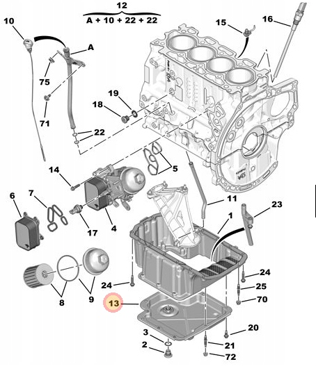

Hello!
Having problem that my oilpan/sump leaks from where it attach to block. Next week is warm so I decided to take it off and re seal it. Havent found any document about the torque for the bolts. Crisscross pattern is probably best for tighten but anyone have idea whats the torque value? It would be awesome. Oilpan drain plug I have seen in youtube videos saying 35nm
I attach picture of exploded view and its number 1 what is leaking from top
Posts: 21038
x 8080
Re: Berlingo 2019 Bluehdi 1,5 oil sump torque
The 2018 Berlingo diesel had 12Nm listed for the sump bolts but I cannot find a reference to a 2019 model. :)

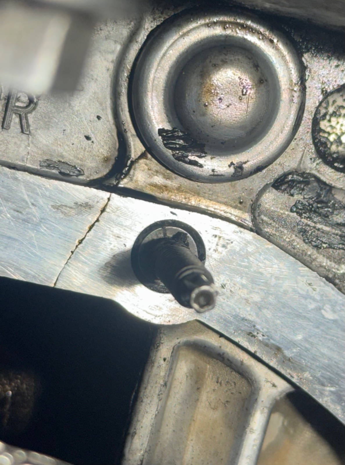

Looks like re seal wont do anything. Block is cracked😖
