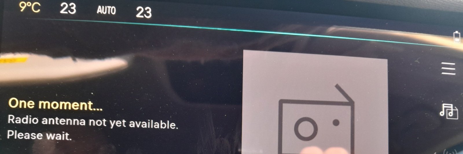

Today, the radio is dead, no signal no radio stations showing, no sound
The sat nav display works visually, but the location is all wrong and its showing no signal, so pretty useless in truth.
The connectivity on board wifi will not connect to the Stellantis servers.. flipping the on /off switch it defaults to off.
It's not finding any wifi networks that it usually does.
Stopped and started the car numerous times today, radio still dead.
The settings screen displays 'One moment.... Radio antenna not yet available.Please wait.' See photo
So I reckon its the sharkfin aerial telematics unit thats kapput?
There is just no signal at all.

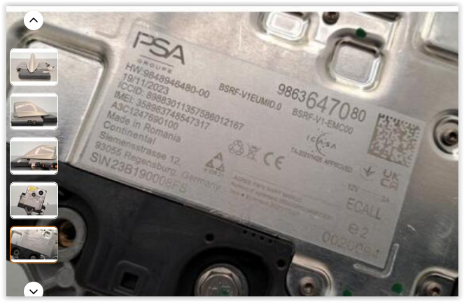

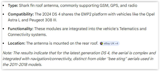

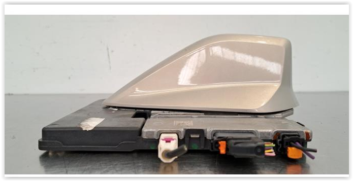

My understanding is the Sharkfin Aerial IS an integrated comms module for GPS/ GSM/ Radio.
All of which have ceased working during the last few days.
It would appear to be a very complex bit of kit, including having a cooling fan!
As may be seen by the PSA part I have now established, there are also a number of comms cables attached.
These must all be buried in the cars roof headlining...
They appear to be common parts in the Stellantis range, including DS, Opel, Vauxhall and Peugeot, and others !
My research also shows they need to be coded specific to the actual vehicle in France, so I may be in for a bit of lengthy wait ( assuming that's correct)
Googling comes up with this to support the above:
Just found a 2nd hand used ones for between £50 and £500 !+ fitting + coding !
Can just imagine the new cost from PSA !

I can see that the information has been collated by an AI so I would look at the source that the AI has consulted. When I use my Brave browser it gives me the sources it's looked at so I can confirm for myself. I'm not yet convinced that the fin does contain an antenna for the radio. An amplifier can only do so much to make up for lack of metal in the air.

When I went to collect the car, they had the boot open and roof lining down and a laptop / data cable plugged into the aerial module.
They then put everything back together.. no parts replaced at all, just through diagnostics.
They told me they had to purge the unit, drain the power from the unit, then reboot it.. and that cannot be done via the main battery and BSI reset.
Seems the aerial module had stopped communicating with the main radio / head unit and the unit that's in the SOS system at the front.
So they reset and everything came back to life!
I am assuming the aerial unit has some sort of reserve battery and they flashed its memory.. dunno tbh.
All my saved locations in Sat Nav are back as are all the radio stations.
