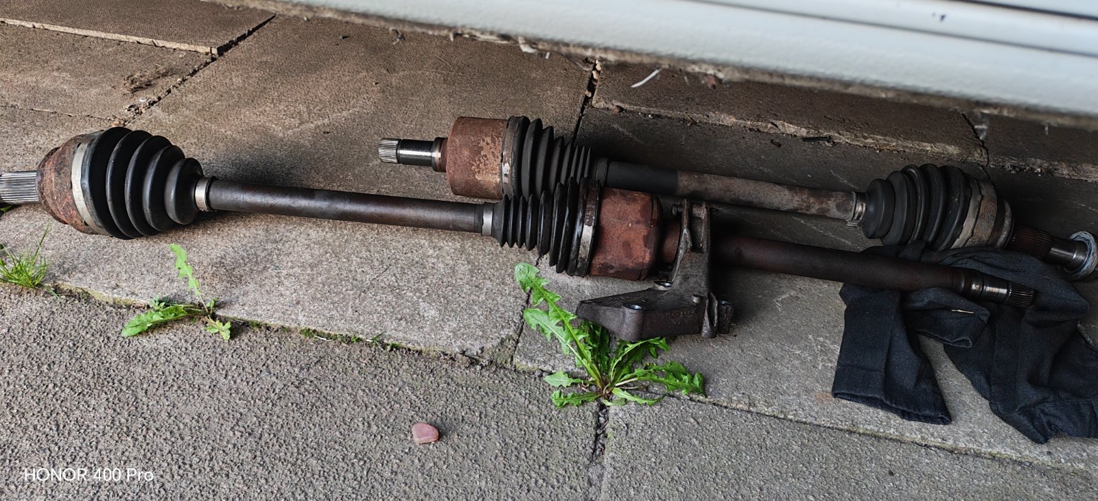

Oh , and any hints how to take the long driveshaft out ? i undo the 2 bolts on the carrier and tried to pull it out , but it won't budge .

I managed to take driveshaft out in the end , but with the bracket attached . Any advice how to pull the bracket off ?
