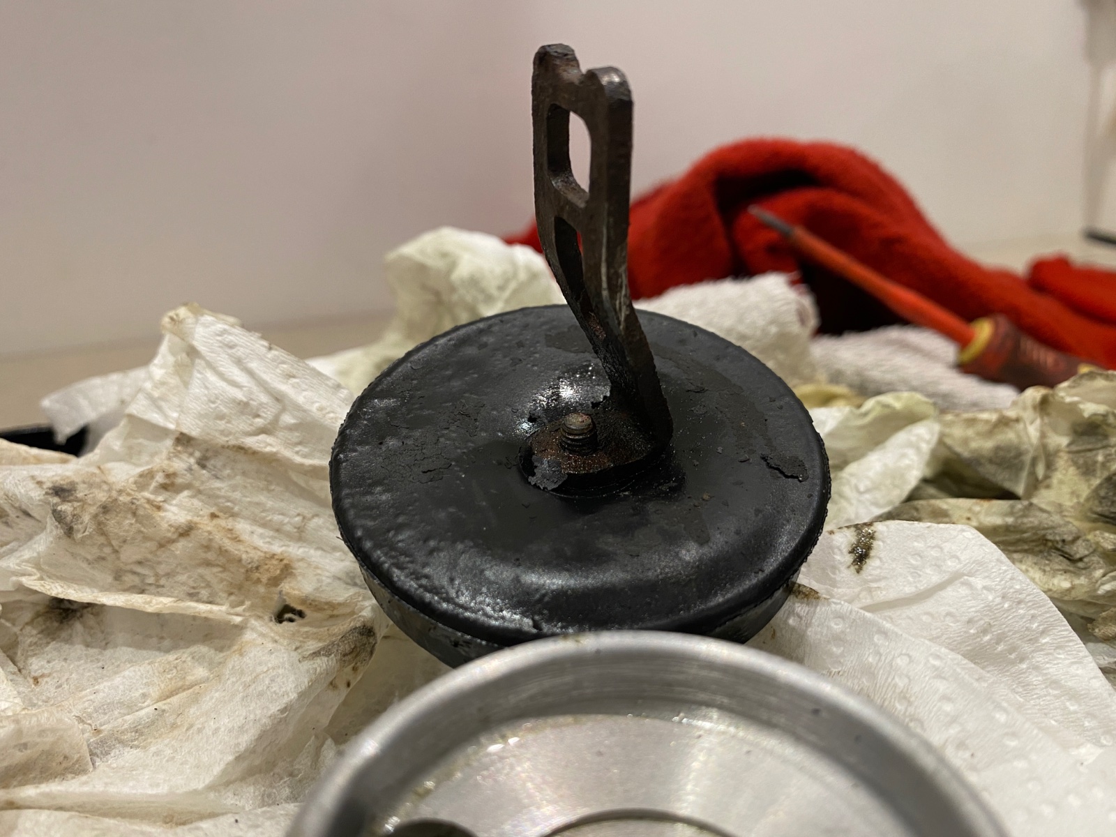

How do I remove the bracket on the rear of the height corrector? Anyone got any good ideas please?
I’ve done some years ago but cannot recall how to do it.
Could I / SHOULD I clamp the “camshaft” in some wooden blocks in a vice and use that to remove the bracket.
Or should I just try and clean the rear diaphragm / disc / spring etceteras whilst it’s all together for simplicity?
Also, just how free should the levers be? Ideally floppy under their own weight I guess but I am not sure that is happening with this HC bracket?

That bracket should unwind from the end of the slide valve. It is locked by a thin nut that comes off first. Then can unwind the plate. It's probably corroded on though. It appears in your pic that the full slide valve is removed from the valve casting. If so, you really don't need to remove the bracket from the slide valve unless the rubber diaphragm is split and to be changed.
I think you can carefully clamp it to hold but I'd be super careful. I think I did just that work some of mine in the past.
Re the cradle levers, I think they should be simply movable without much effort. If they're so loose they fall under their own weight that's surprising. Lends me to think they might be worn. But better than seized..

Did Mine with a vice and some padding around the spindle, followed Jims guide.
https://eastment.net/hcrefurb/index.htm
