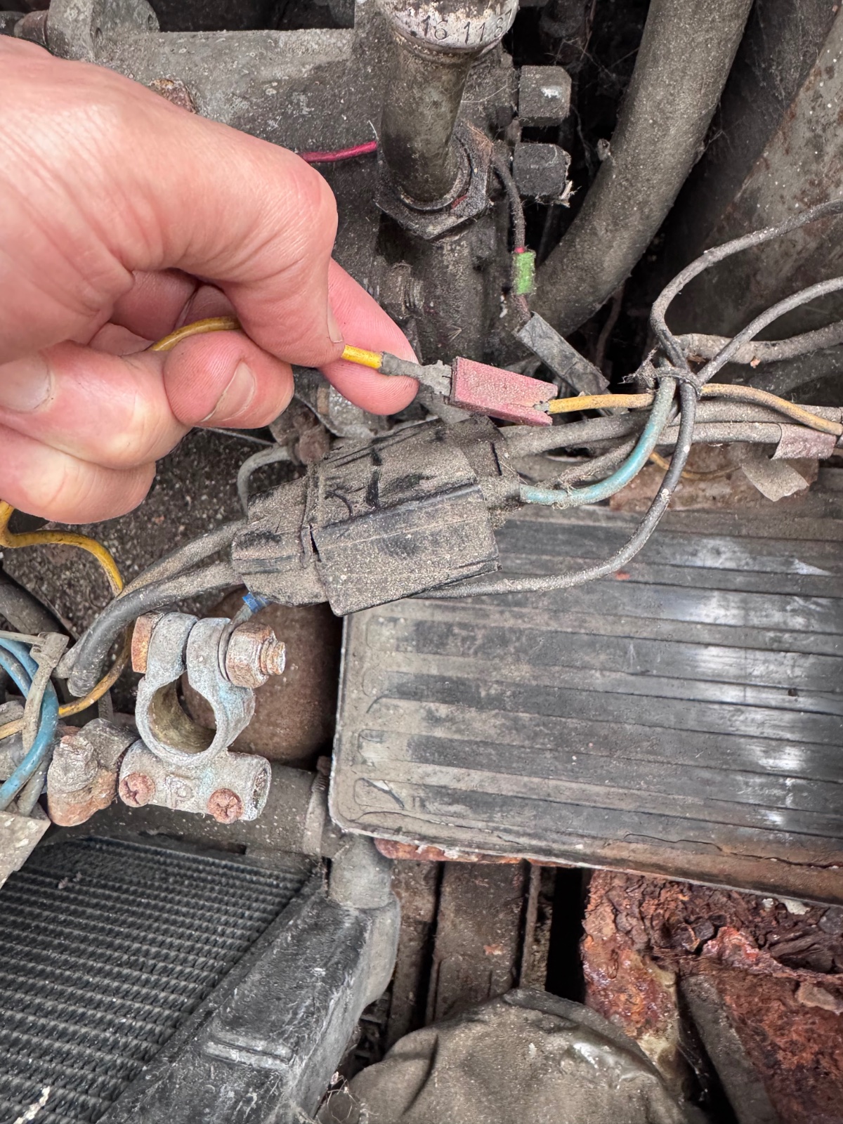

Fourth - make sure car is in a neutral and then look at the battery, near the positive terminal. You'll see a wire (possibly yellow) with a single spade connect male-female (probably red coloured housing). Disconnect that and touch the side nearest the engine, onto the positive battery terminal.
The starter should crank.
If it doesn't, then the fault is with your starter/the cabling from battery to starter.
If it does crank, then the fault is between the ignition switch (could be that itself) to that spade connector. nb: if you have ignition on and hold the terminal to the positive terminal, you can crank until the engine starts - one of mine has always had a temperamental ignition switch and this is how I start it, when that happens!

Photo of the single wire/spade terminal I’m referring to, near the positive terminal on the battery.
Caveats: The cover on the left hand half of this connector is broken/fallen off and this is actually a pic from the DTR T2 on my driveway, rather than from one of my GTi Turbo’s, as they’re away in barns. The wire and spade terminal covers may be a different colour, but this should at least give you a clear idea what I’m talking about!
