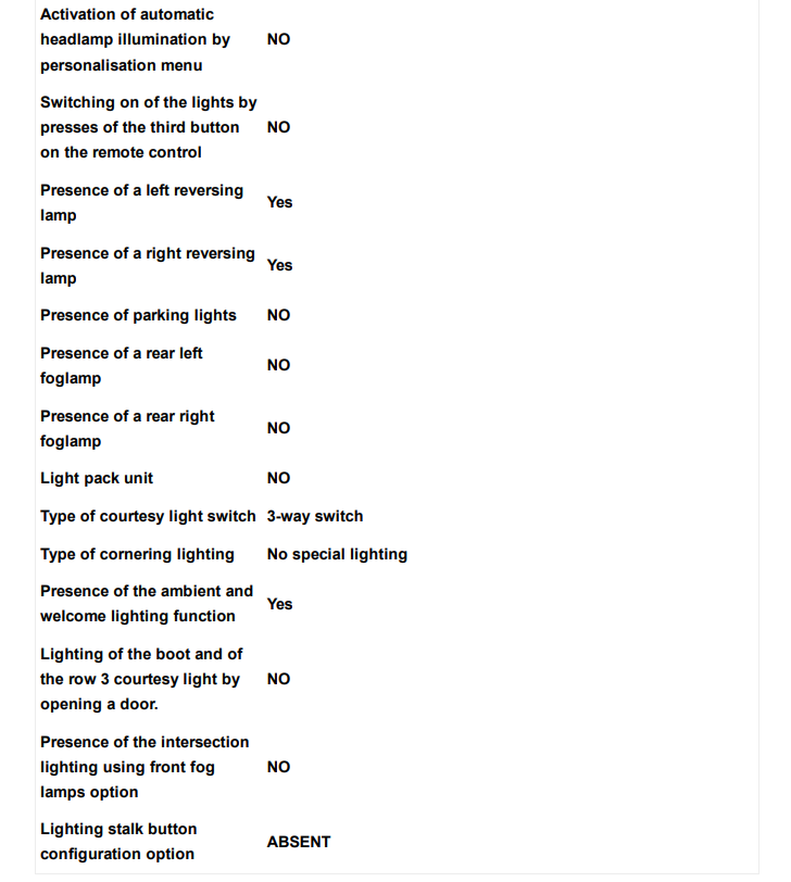

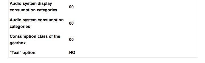

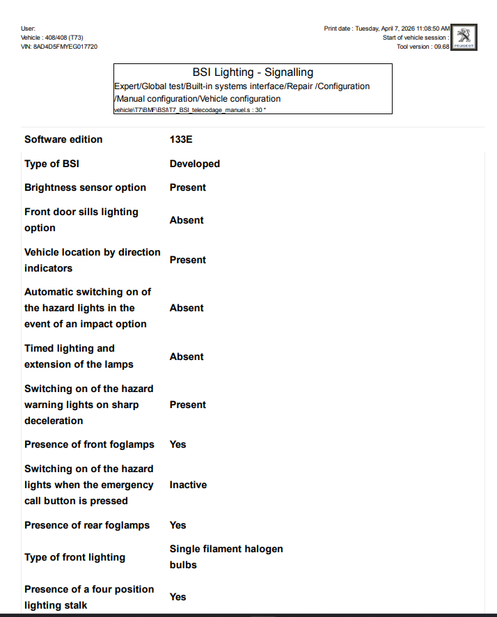

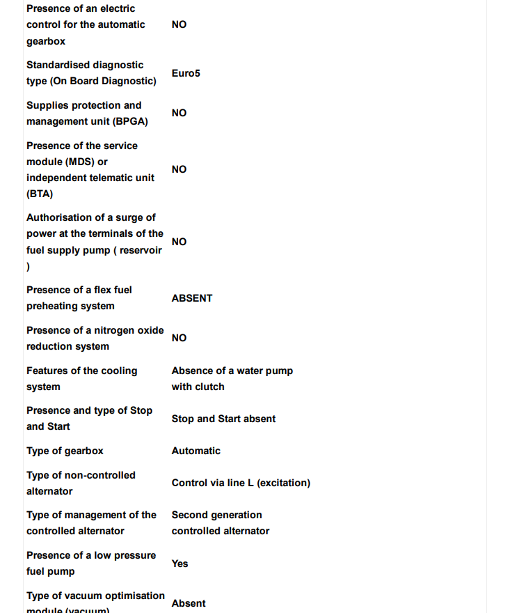

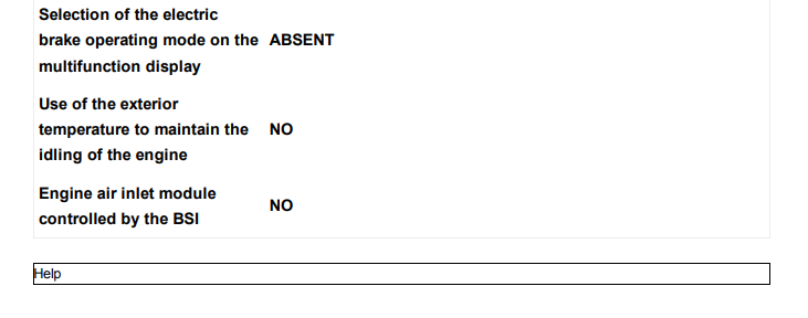

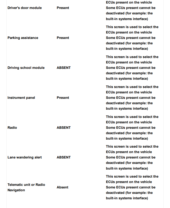

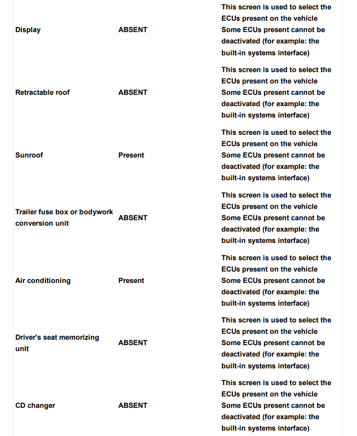

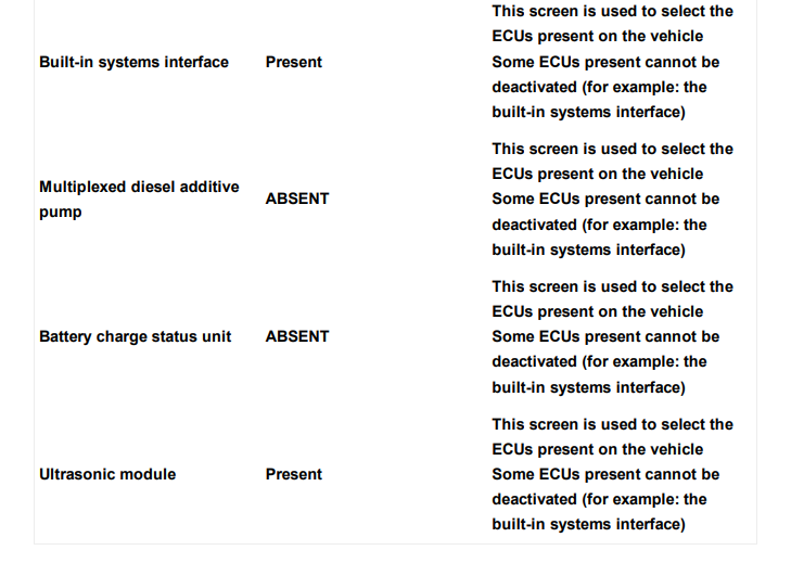

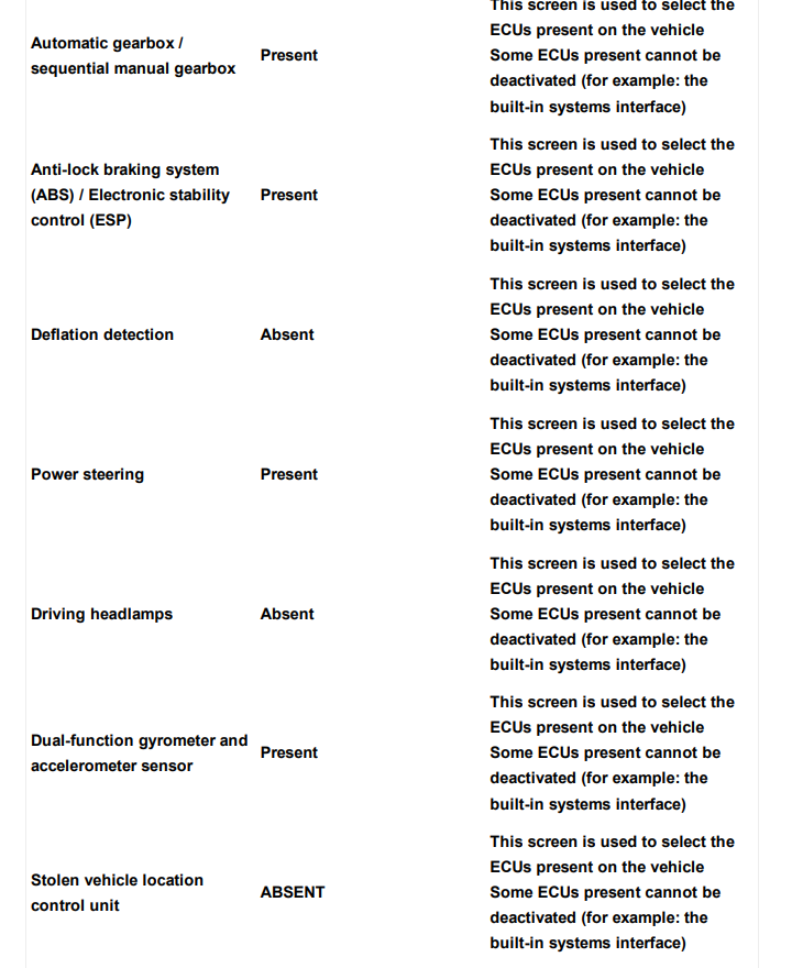

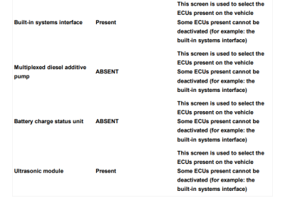

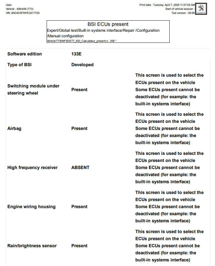

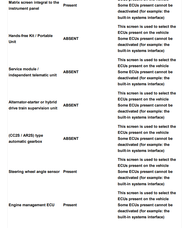

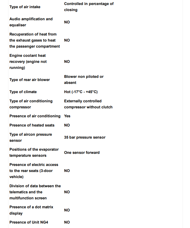

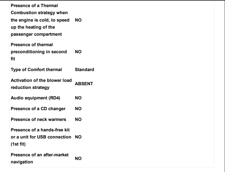

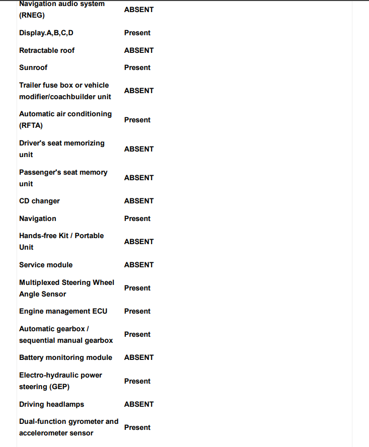

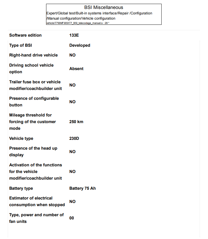

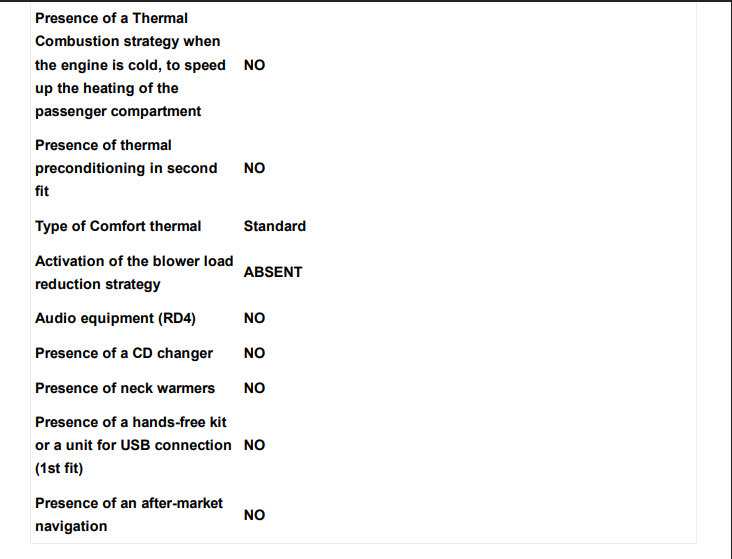

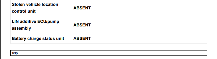

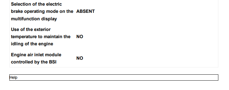

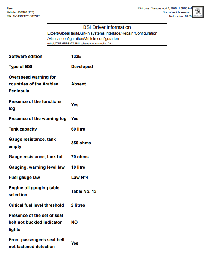

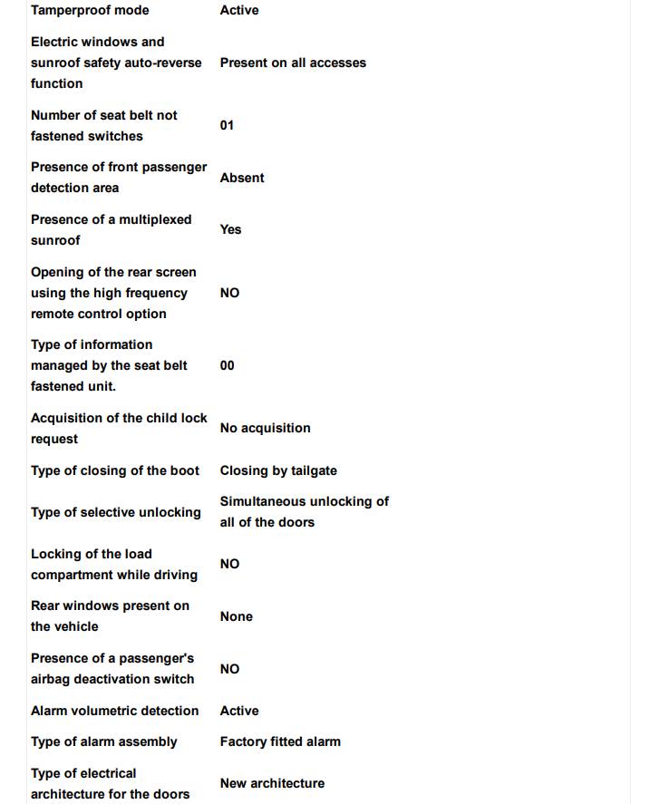

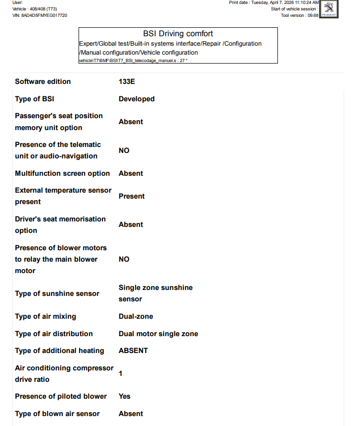

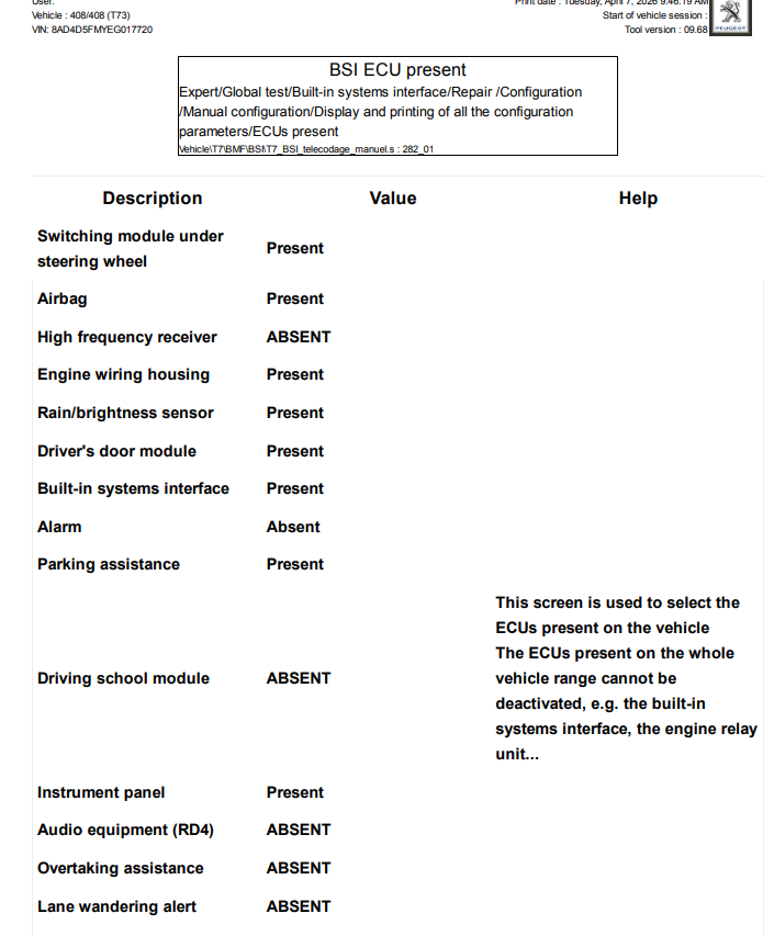

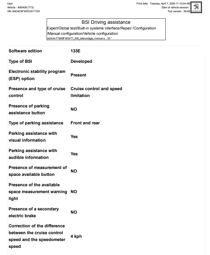

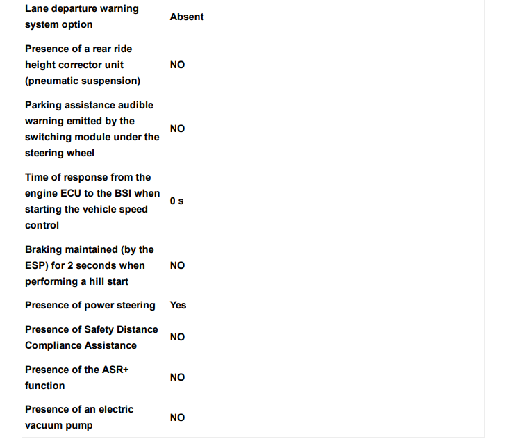

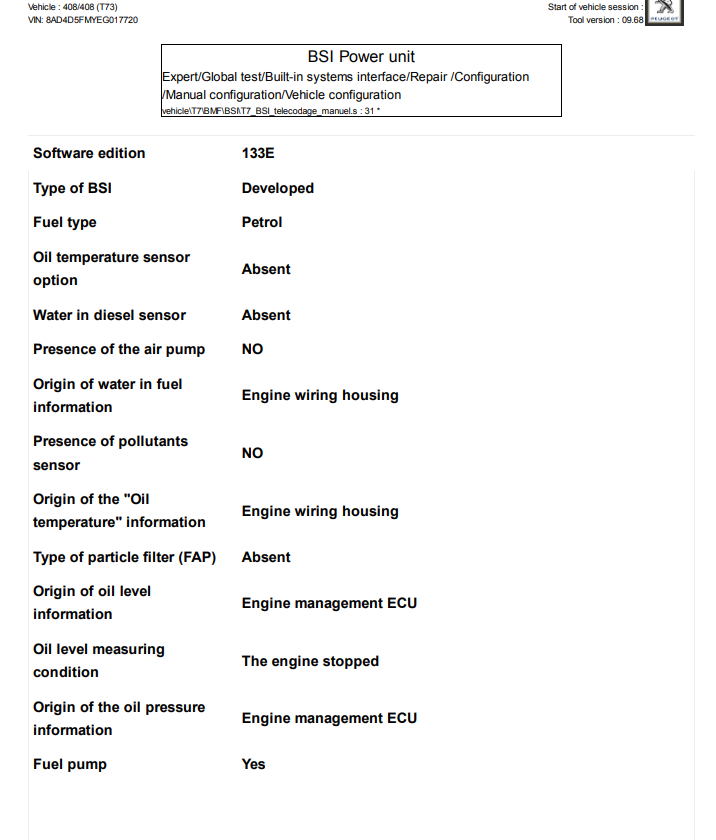

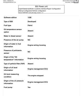

I also took the opportunity to run some additional tests. Even after disconnecting the RNEG, the error persists (which makes me believe this rules out a problem with the unit itself). The error only appears after starting the vehicle (if the error is cleared and the engine is not started, when connecting Diagbox the next day it will still show no errors). This leads me to believe that when the vehicle starts, the BSI is waiting for a signal from something that was configured, and since that signal never arrives, the error occurs.
Everything in the vehicle works perfectly (GPS, radio, audio, Bluetooth, CD, steering wheel controls, onboard computer, etc.).

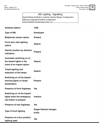

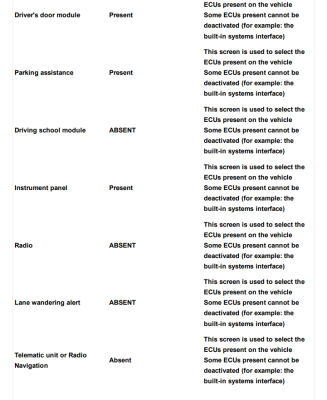

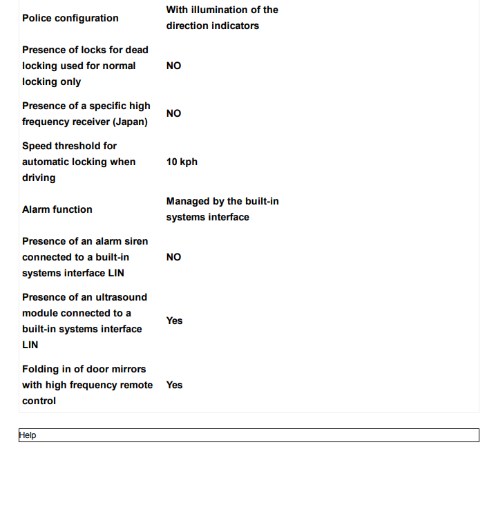

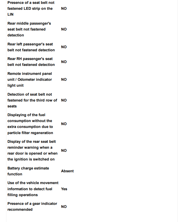

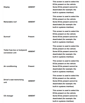

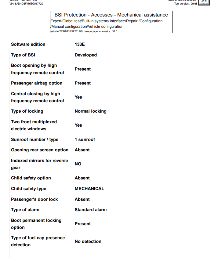

This is the current BSI configuration.

Driving Assistance

Calculators
Power Unit

Lights

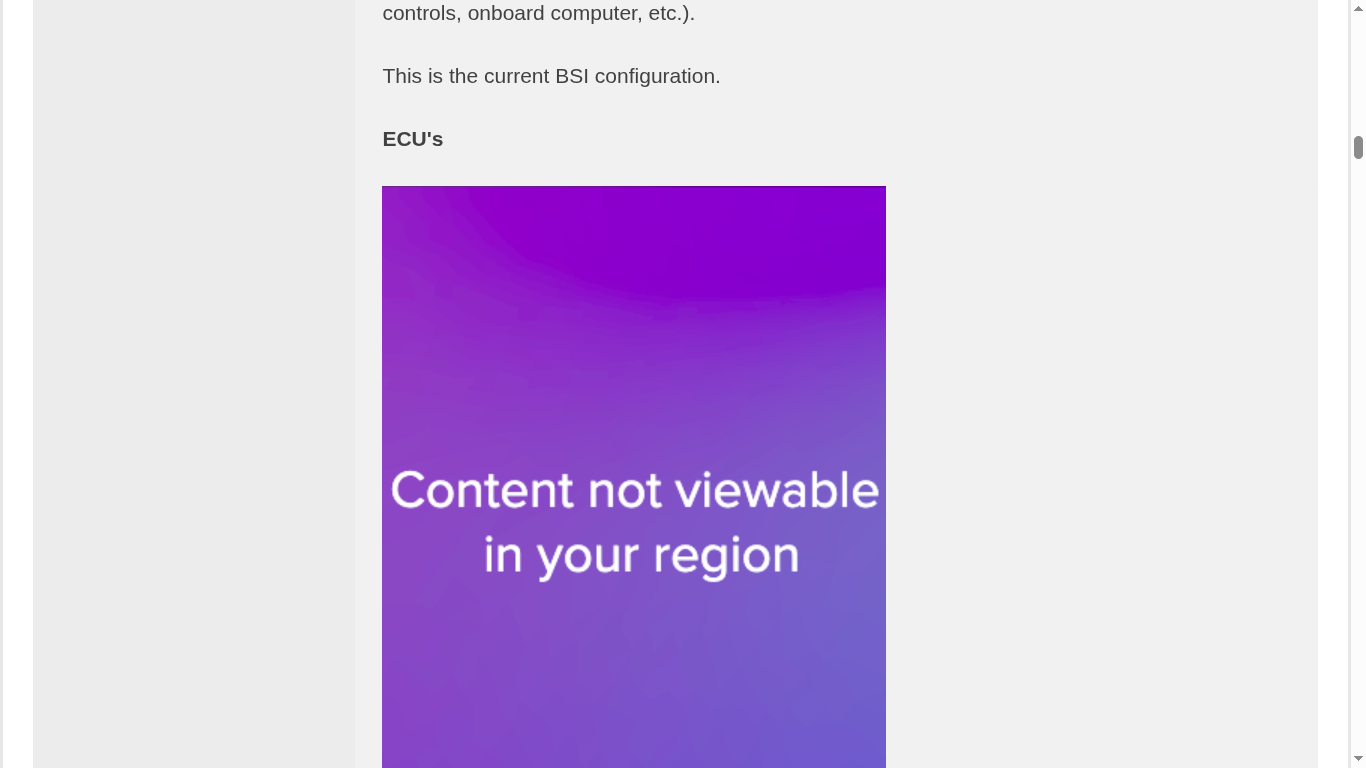

Re: Engine Light Problem - Error F023 Diagbox
Your images are not being displayed here. Presume they are on Imgur which doesn't permit UK viewing.
Can you upload direct to the forum? A guide here
Posts: 21138
x 8119
Unfortunately your image host does not allow us to view their images in the UK. However you can upload the pictures straight into your post if you follow the guidelines here: :)
viewtopic.php?p=516529#p516529

cesar4585
Posts: 5
Joined: 02 Apr 2026, 23:29
Unread post by cesar4585 »
mickthemaverick wrote: 07 Apr 2026, 18:40 Unfortunately your image host does not allow us to view their images in the UK. However you can upload the pictures straight into your post if you follow the guidelines here: :)
"Sorry, I wasn’t aware of that.
Fixed."

Edit:
Solved, everyone thanks!
It was actually related to the RD6 screen configuration. After changing it, the F023 fault disappeared and, consequently, the U0140 as well.
